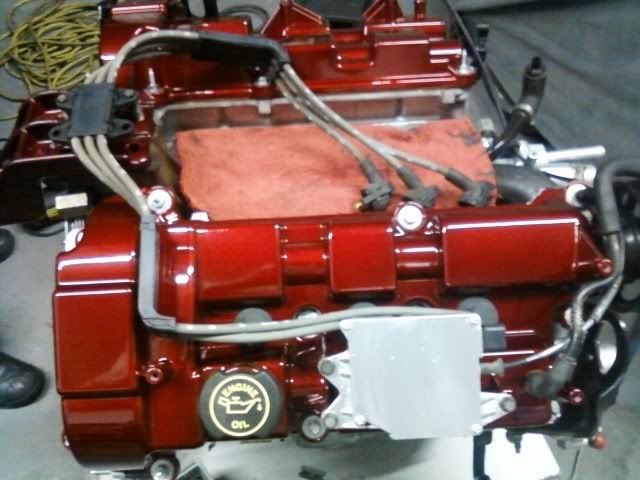

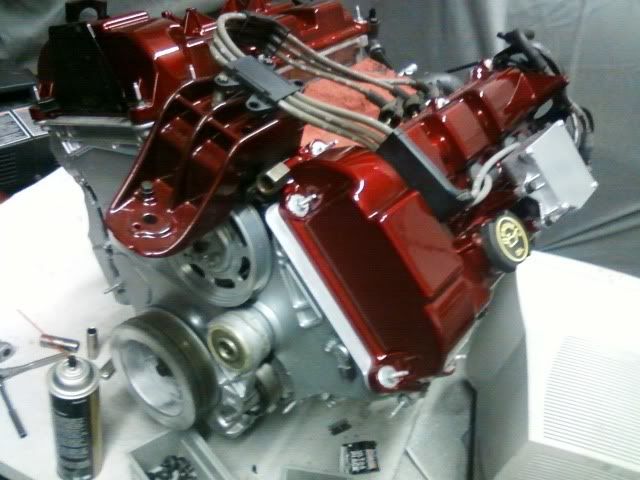

SVT UIM, its going to be a port matched engine this time.... The next one will be a full MPV engine.
Any indication of what oil pan is used on it?
This looks like a great new option for 3L swaps. When I bought my engine I had started to look into other 3.0 applications but the extra cost outweighed the pros of the other options. In my case it was $400 out the door for an 04 Taurus engine vs. $1000 + for anything else.
I wonder what cams they use in it... I'd be willing to guess that they're similar to the escape cams. Any thoughts?
I havent gotten under the engine to check the part number for the oil pan but I would guess escape. As for cams.... Im not sure... Once I pop the valve covers Ill take more pics but I need to port the heads first.
This engine will be a port matched and the full mpv will be going in the green svt I bought.
Plus the black car is sale pending already :)
As for a portmatched swap the only thing that stands in the way is the cranckcase vent box going inbetween the heads. I had to do some really funky stuff to fit it in there.
But for a full 3L its the easiest thing you will ever have to do.

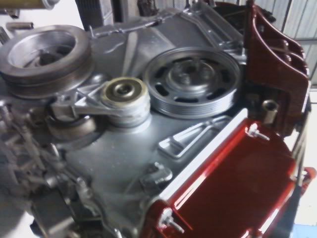

Also as stated before it comes with the 01+ cougar alt bracket and alt. If you wish not to use that then you can remove the bracket, cut the tabs that normally need to be cut in that location and install the Contour bracket with no issues.

Basically I was going to go full mpv but someone has made a down payment for the car and I wanted to give them something they could drive right out of the box without having to worry about tunes and what not. Not sure the level of knowledge they have on the tour either so this was a safe route for me.
The oil pan is an escape oil pan with baffles.
Basically this engine does cost a little more to obtain but you are getting alot of goodies with it that justify the cost.
