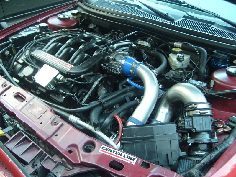

thats what ill be doing later. gunna jack her up again and get under ther and figure it out. just did some gear pulls and pulls like a mofo in 2-5th no 1st gear runs yet wanna break in clutch lol yep but boosting around 6-7psi running hot around the L of normal but dunno if thats normal since its blowing hot air in instead of it being intercooled which it will be next year after techschool prob dec 08 jan 09
No it shouldn't. You know I might not have even hooked up that VSS. I made a mental note but I don't remember doing it. You might get under there & see the plug hanging! :blackeye:
yea ill find out in awhile if its hooked up or not. also i gotta get this car running cooler. got the right antifreeze/water mix and water wetter. trying to figure out why so hot. the fuel/air mix is off ...need tune and dyno tune but other then that she feels fine. its rich so i dont care all that much. rather run rich then lean. it SHOULD be getting enough fuel with that huge gas pump and im guessing the FMU could be having some issues. Anyone know anything bout the vortech FMU is it a peice or what?

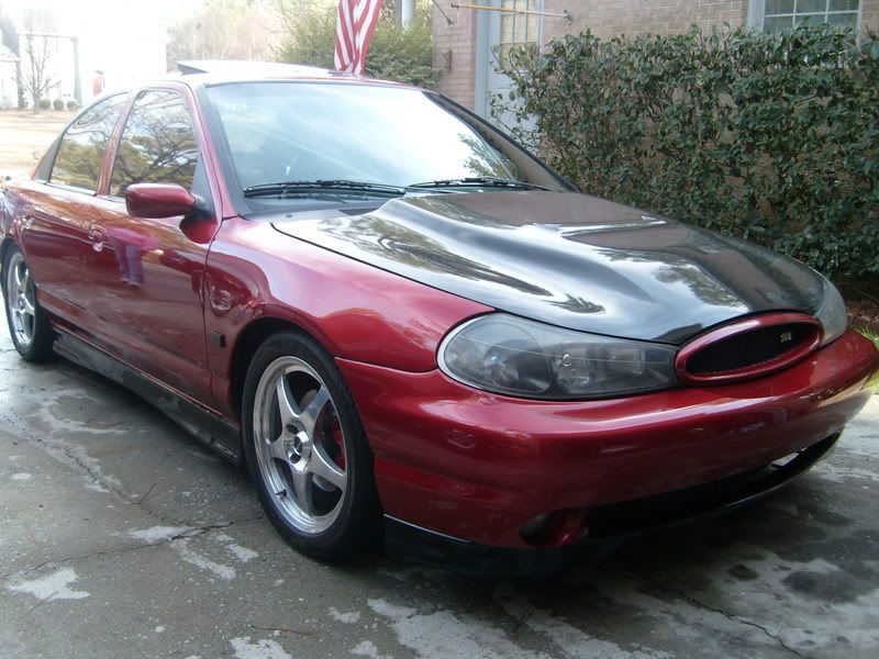

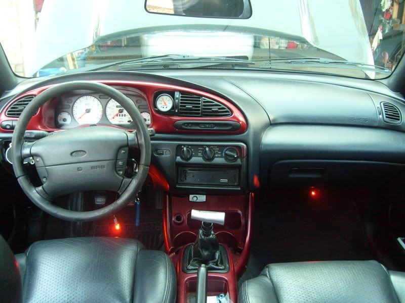

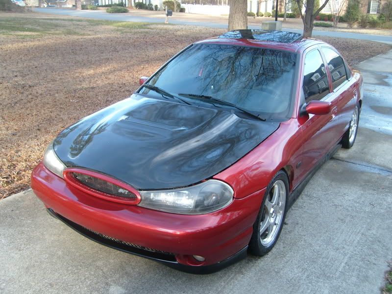

well i know im postwhoreing but cleaned her up today and took some nice shots enjoy......the interior is still going under big changes...look for all black leather and black fiberglass'ed console once im back from basic/tech
