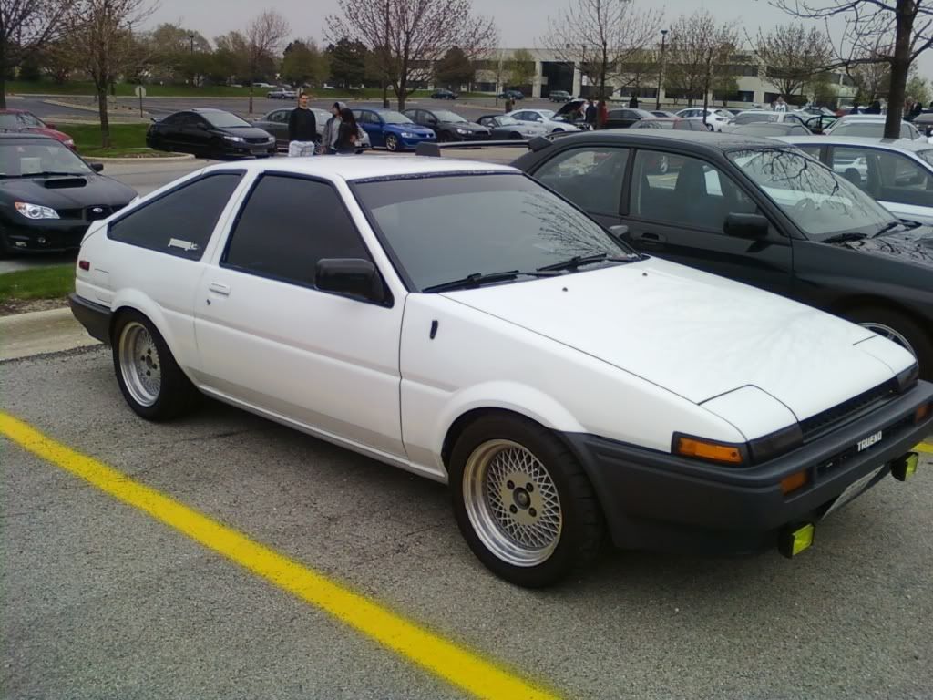

My 86...

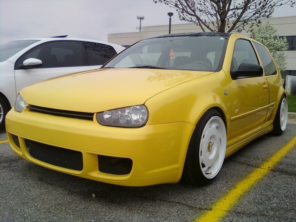

....and here's that Golf w/ the 91' era Corvette wheels!
The Golf had a bumper sticker that read PUCK FOTHOLES:laugh:
