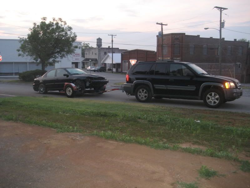

Car is now loaded on a tow dolly ready to leave going to ob1's house for its heart transplant and reassembly!
