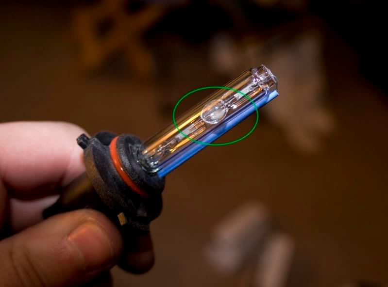

So I bought the DDM kit. Installed it, turn the car on and flick the switch...nothing. Neither bulb fires.
Everything was installed correctly. I took a look at the bulbs, and Im not sure if this is normal, but both bulbs have like a haze in the center spherical part of the bulb (circled below) They were like this when I took them out of the box. Whats going on?

that's normal. All HID bulbs have that. It is the collection of salts that produces the color.
couple things to try...first is try switching the positive and negative on the bulb. A lot of the kit companies have the wires switched for some reason.
Does the DDM kit have a relay that connects to the battery AND 9006 socket or just the 9006 socket?
If it connects to the battery double check the + and - connections again.
Do you hear a "click" "click-ing" or "buzz" when you try to fire the bulbs?
Try that and let me know what you find
