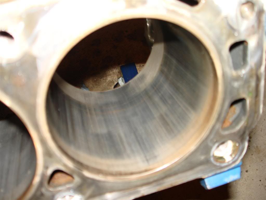

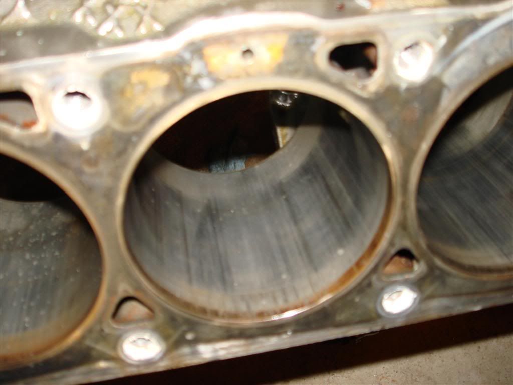

i wouldn't run it. As SicSE has already stated, you can run it on the 17 lbers. thats probably what I would do. I def wouldnt run it with the hack. Check out how my engine looked after running for 10 minutes at idle with a messed up MAF/injector calibration:
keep in mind it had only 10k miles on it.

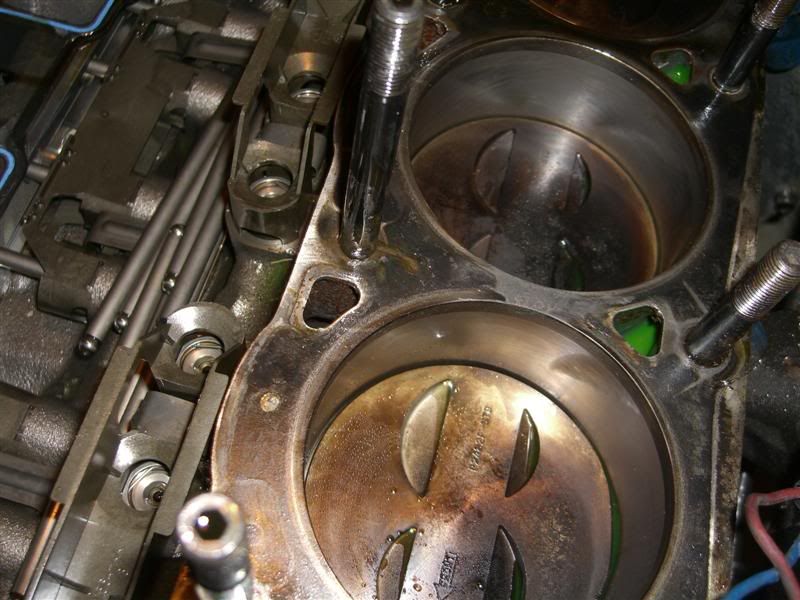

heres what the engine looked like before it ran with bad tune, just incase you thought maybe it was beat already:

re-read. it ran at idle for 10 minutes. being boosted has nothing to do with it. the damage came idling in the driveway. i never even drove the car. my point was it had 60 lb/hr injectors and a MAF calibrated for 30 lb/hr. The tuner changed the function thinking the meter was a lightning, so a 42 lb/hr maf, the tuner thought he needed 30% less fuel (meter 42, injectors 60) when in reality he needed to pull 50% (30/60).
it was a ford racing 30 lb/hr meter, old skool from before the lightning was even built.
ahh, thats pretty sever damage for only 10% more rich than the 24s will be
