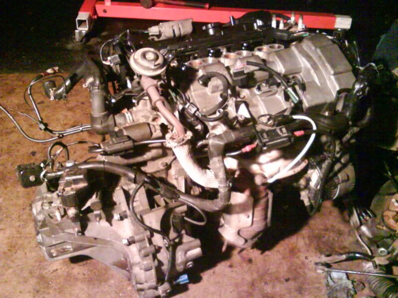

Well after finishing up the last of the odds and ends things seem to be going well. I've finally got some repeated codes to work on. It's the usual 171/174. I'm pretty darn sure there's no vacuum leaks so I'm leaning towards a bad MAF. I already cleaned it, but to no avail. I was looking at the Rockauto website and they list the same PN for a SE and SVT MAF. I know the housings are different, but what about the physical sensor itself? Can I swap the SVT with my known good MAF from the SE to test? Any other suggestions? Also, the front end seems to torque steer like a B! now. Is this normal for the SVT's or perhaps I've got something screwy going on. I checked my ball joint, tie rods and Toe settings and all seems well. Maybe a bit too much toe out for the street (1/8"), but we run that on the racecar all day long. It didn't effect it before the swap???
As always any suggestions welcome.
