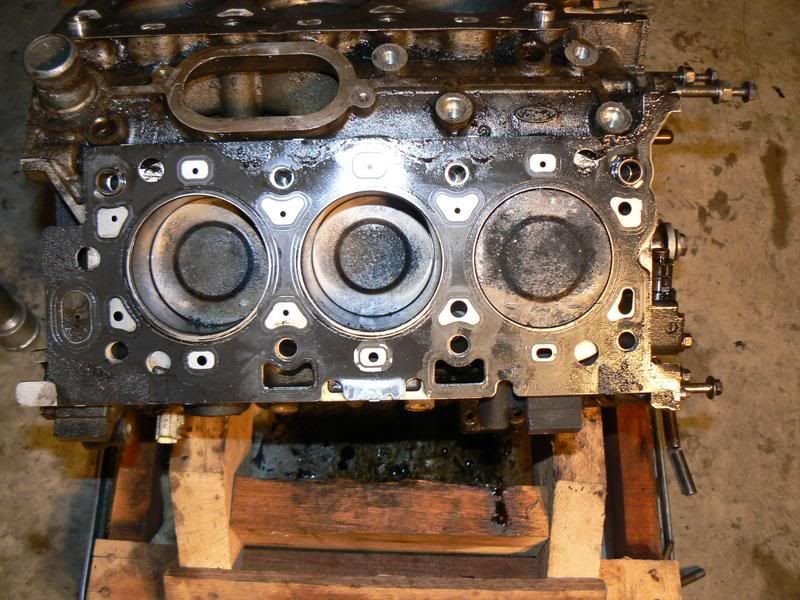

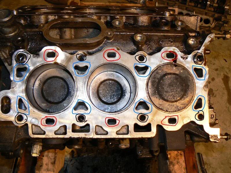

I took some pictures of the head gasket and stuff. I don't know if there is confusion or not but if there is, maybe this will help a bit.
With the head gasket on, you can see that all of the passage ways are blocked to keep everything seperated.
With it off you can now see the different passages.
The blue circles are the water jackets.
The red are the oil passage ways.
The black are for the head bolts.
As you can see, it is really tight in there. And it doesn't have to be a catastrophic blow out either, just a tear. It could affect just the coolant, just the oil, just compression (by blowing out between the oil and coolant and not actually hitting either) or all of the above or any combination.
To replace the gaskets, aren't hard. But new head bolts are expensive, the head may need to be decked, you'd obviously need a new head gasket and so on.
