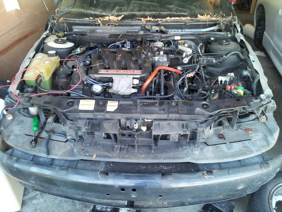

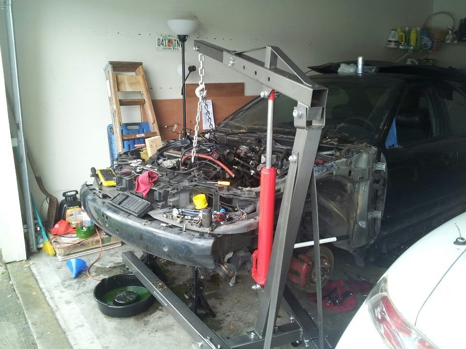

Finally moved into a place with a garage and has ample room to start tearing it apart, and heres where Im at now. Got the front end off of it, and started pulling the necessaries, and some unnecessary things, and eventually will have the motor out when I get some motivation to do so.

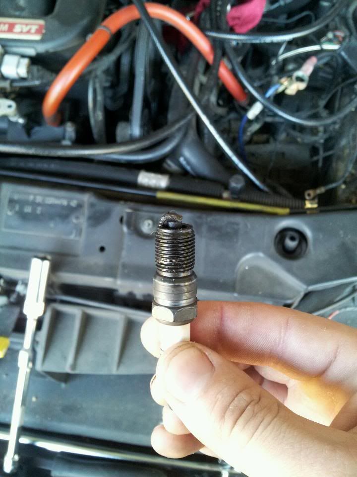

Found this gem while pulling out the plugs, front bank center cylinder, nice and flat plug.
