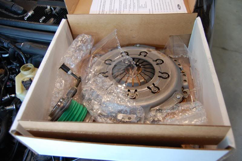

Here is the clutch kit that is in the car right now:

I think the true tail of this story will be once we see the actual disk surface. If its worn excessively (granted it is 30K) it very well maybe that he is just pushed the clutch past the mechanical limits. But if it looks like normal wear and tear I think we are looking at more of a clutch material issue.
Then the question is can we find a clutch thats springs are stiffer, to keep from bottoming out the clutch. I would say we would want to stay away from solid plates, just cause it moves the break point to some where else.
I'm happy that it appears, atleast in my case, the friction surface can take the power of the car. The issue being it just pushes the fail point to the body of the clutch.
