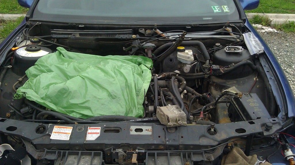

I finally have an engine bay worth showing off now that i got this 3L swap done! Did alot of cleaning and painted the engine bay black, valve covers/imrc blue, UIM/MM/RR oil-rubbed bronze.
BEFORE:
AFTER:
