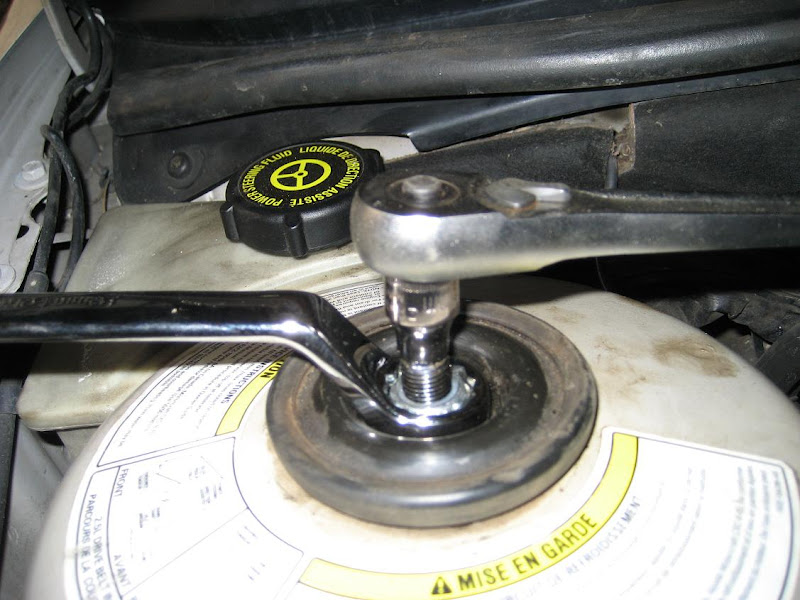

I untightened that top mount nut while taking the half shafts out and now i can't get it back in...
I'm gonna need to get a weird offset wrench or something

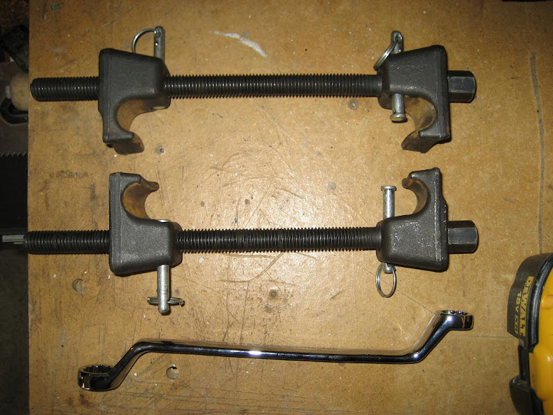

just get these tools. i tried w/o and i was hopeless (unless your struts still come with a female alan, mine was male on the top of the strut) either way this is the ticket.
and heres the other special tool i used . i figured id add it just in case a picture doesnt exist
