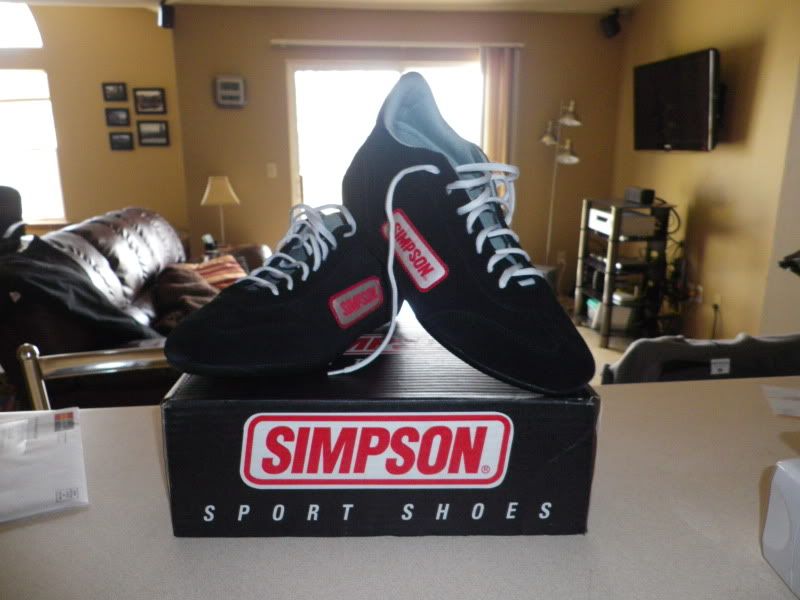

So I'll spare you the details of all the minor boring stuff I did on the car this weekend and get to the good part. First off, stopped and picked up some new kicks, this is the first time I've ever purchased driving shoes and i don't think I'll ever go back.
