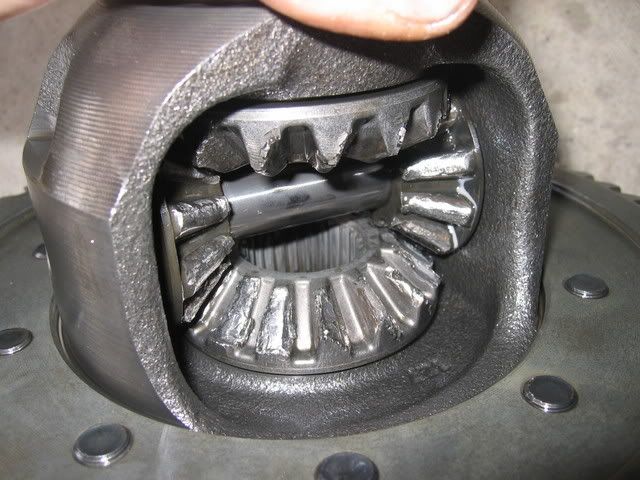

So today I finally got the differential out of the car and man was it torn up. I spent the last 3 days trying to get the second half of the trans case off the block cause from what I thought you guys said I needed to take off the whole case. Well a friend came over today and grabbed the gear attached to the diff and said "can't you just pull this off?". Halfway through me saying No he wiggles it and pulls the differential right out of the case. Whatever, I'm just happy it's off and I don't have to pull the rest of the trans.
Here's the damage:
Tomorrow I'm headed to the dealership to order my new torsen. The dealership told me it would be about $630, but my friends dad gets a 15% to 20% discount so it should be a bit less. I'm hoping to have the car done by sunday so I can take it to school, otherwise I'd shop around more and find it cheaper.
Thanks your all the help!
Way to dive in and do it yourself :thumbup:. Looks like you should be good to go with the new torsen.
