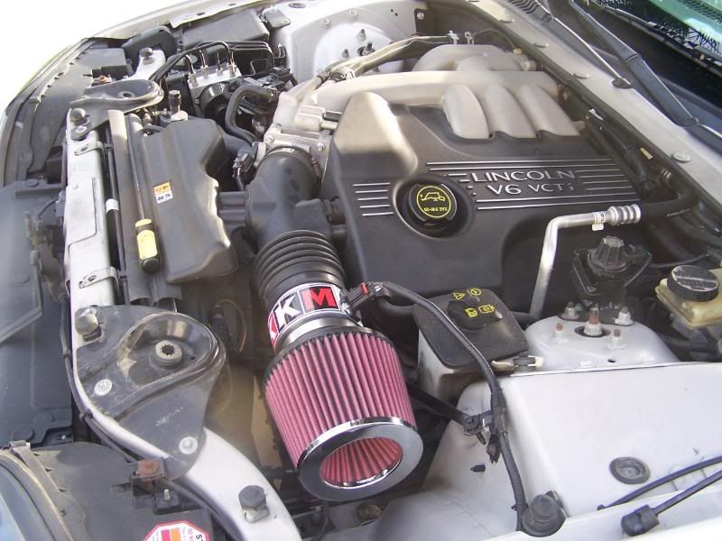

Didn't the Lincoln LS run a RWD Duratec? That might be a good place to start for an oil pan and pickup tube.
There was a 30's street rod at the 2010 Del Shannon Car Show that had a RWD Duratec in it.... I will try to figure out where the pictures went.
