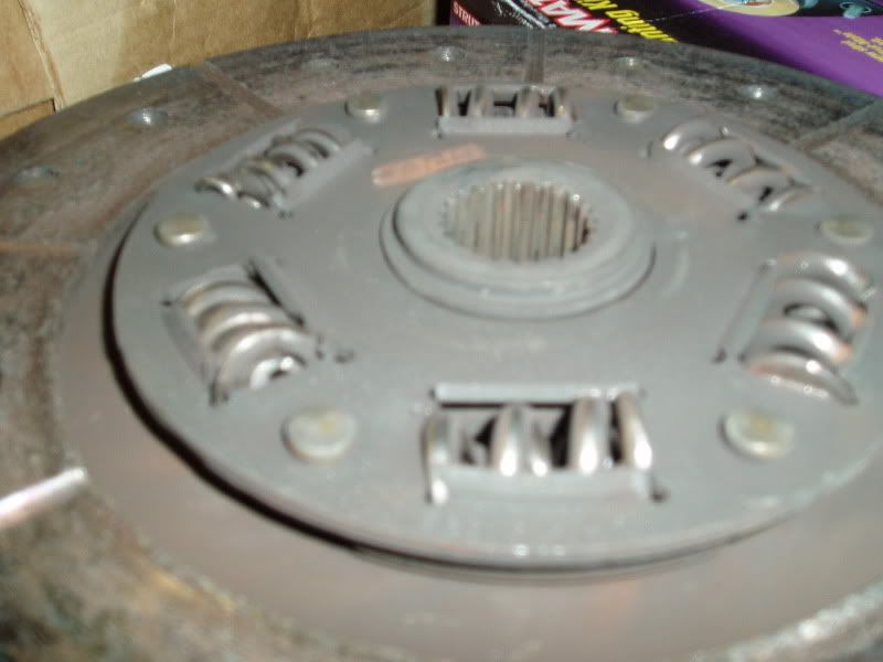

What do the springs in the clutch disc do?
Hey, got a question.
I understand how the clutches and pressure plates work, but im not to familiar with them
From what I understand they absorb some of the "shock" when the clutch is engauged, makes it smoother using over all.
Took my spec out becouse the TOB was making a terrible noise.
The springs were starting to go as well. Some of the springs were broke and the metal holding em in snapped off.
That sucks... but at least you verified what you already knew. I'm pretty sure I'll see the same when I get around to pulling my tranny.
