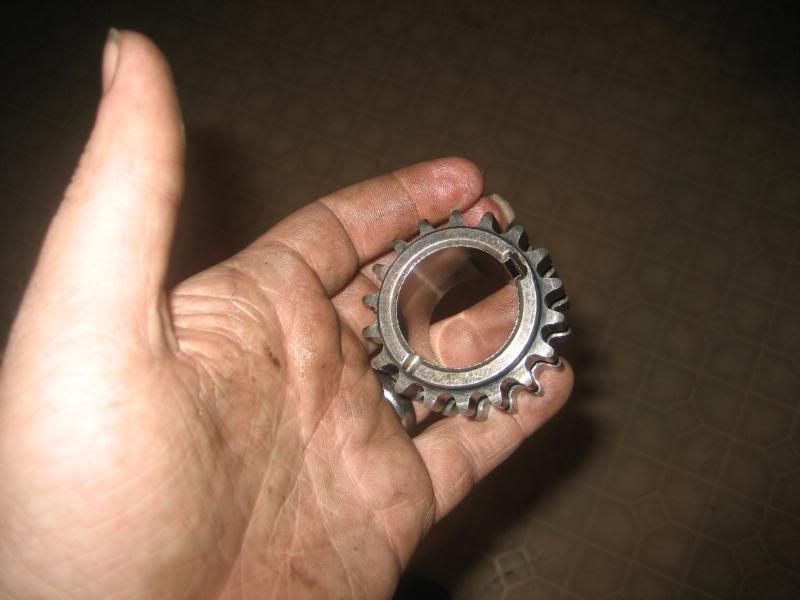

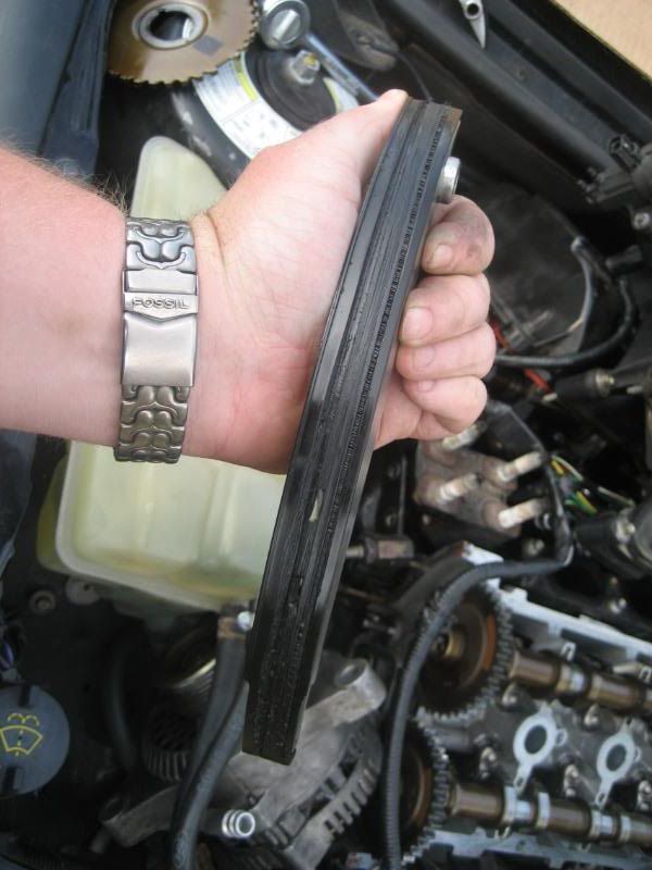

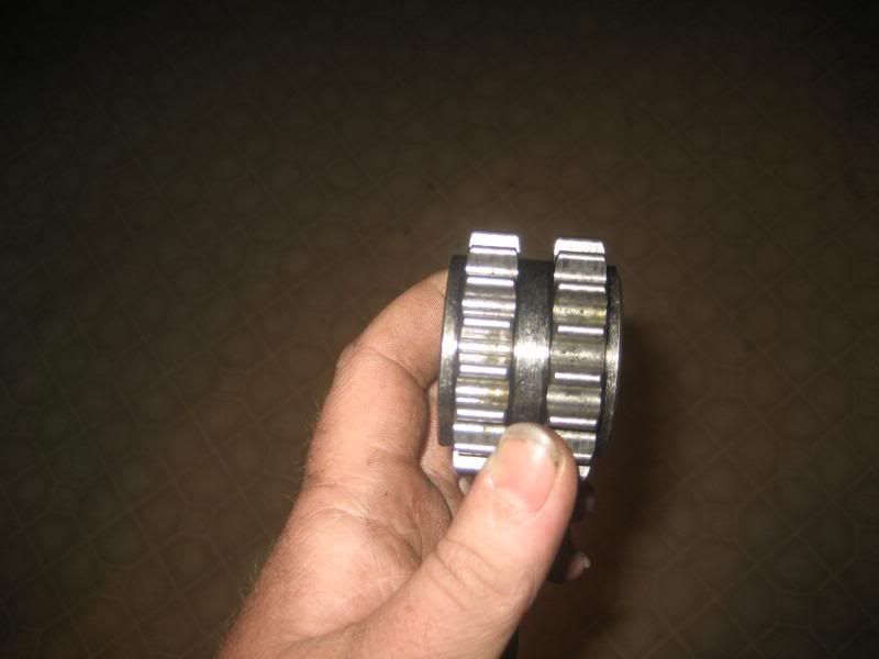

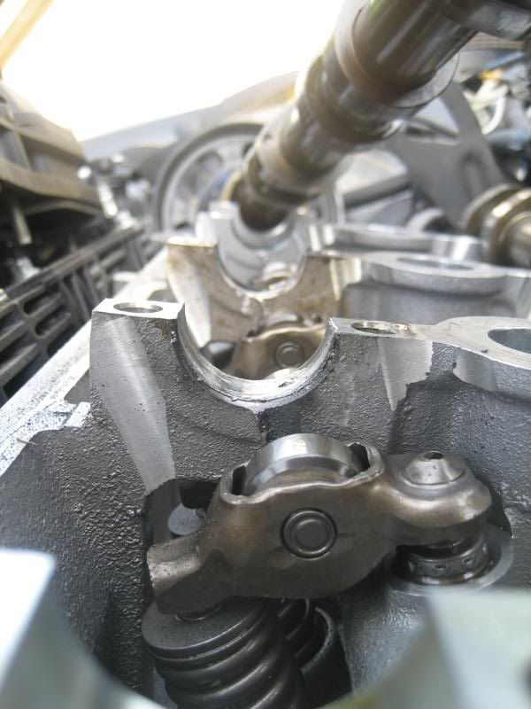

Ok so I got to tear down my 3l and find the root of all evil today. I thought it was a simple thing at first and she would be up and running in no time. Wrong! I am now looking for a replacement motor. so off to the pics. The first few are of the first problem I found. We have a 3L crank timing gear thrown in with all 2.5L timing equip.

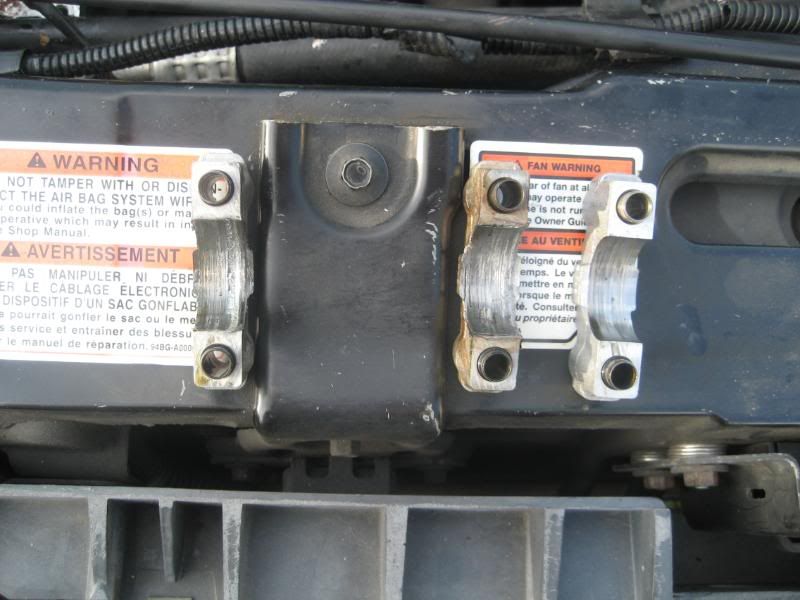

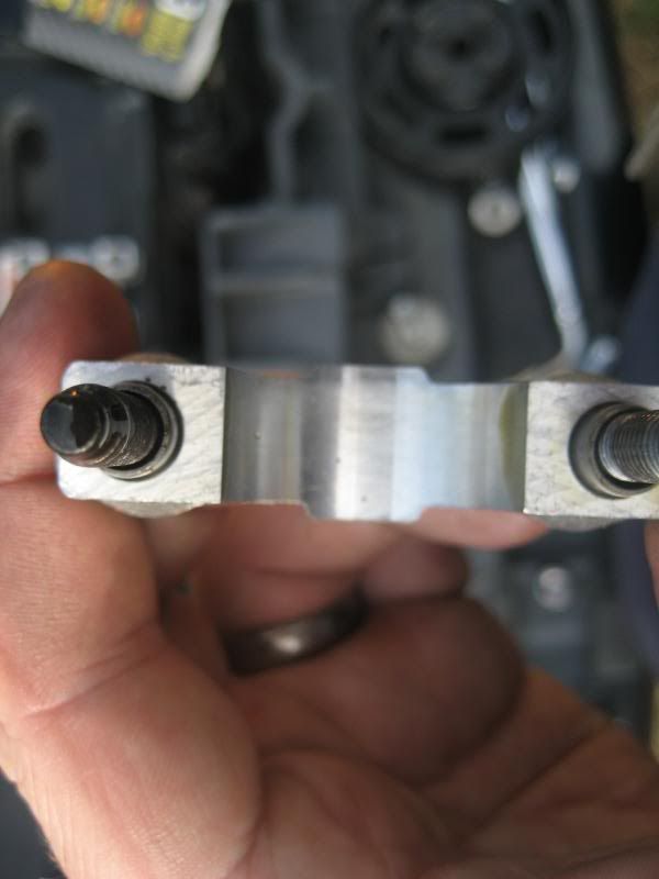

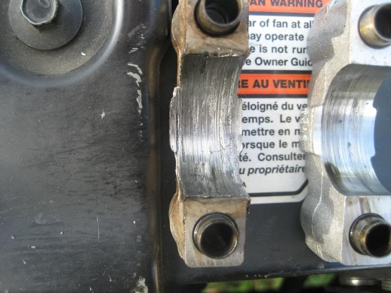

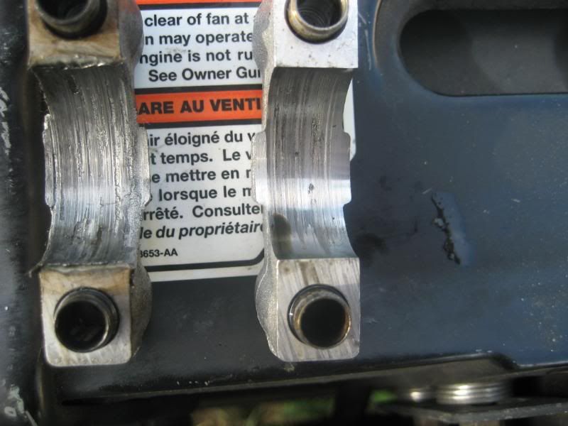

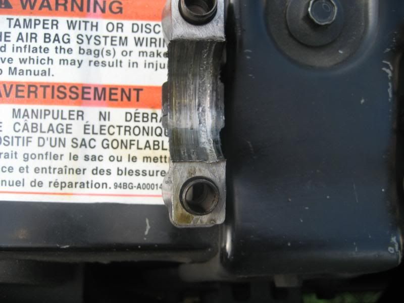

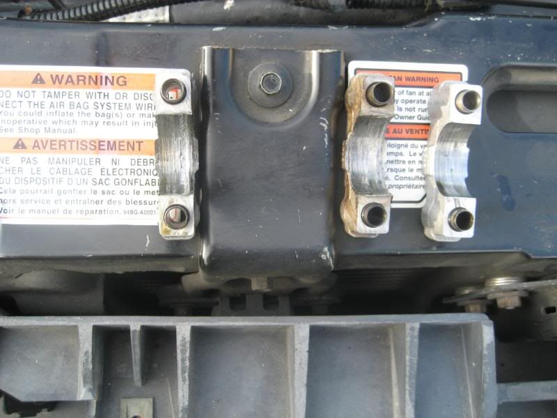

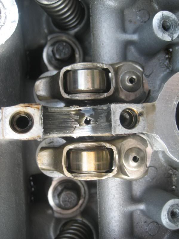

Then I decide to pull off the cams on the front head to see if I can look up the pt# and figure out if I have indeed got SVT cams. Well what do I find? Nothing good here! This is what it all boils down to.

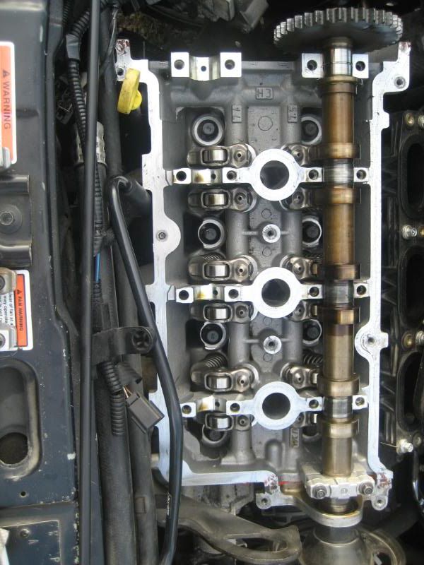

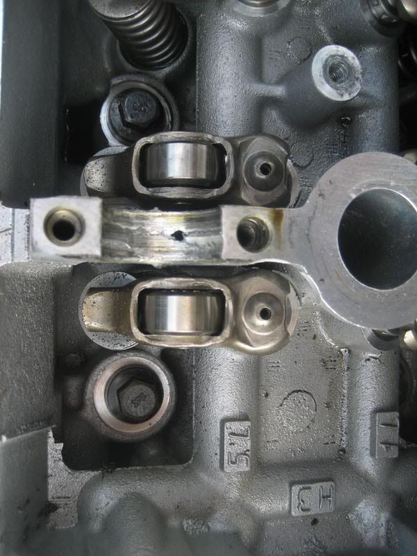

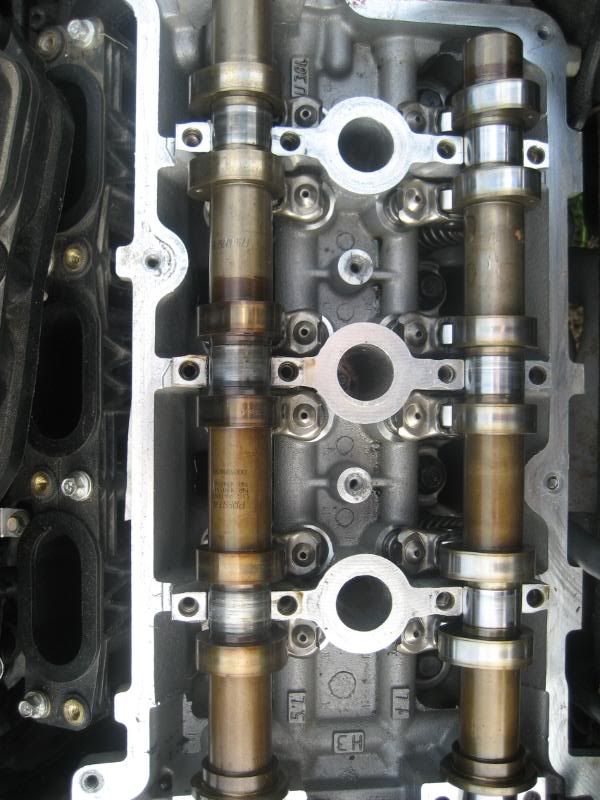

Here is where it gets good. After I pull the top cam lol.

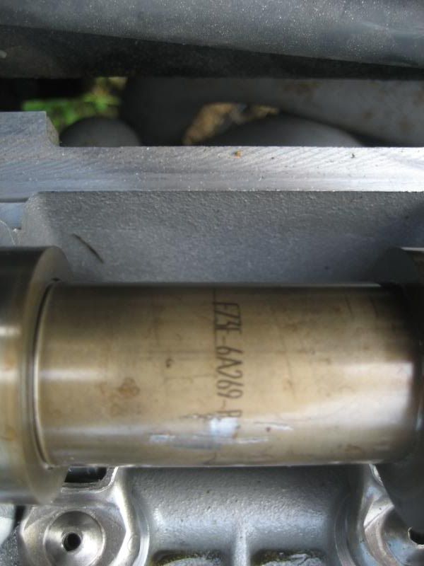

Can anyone tell me if these are svt cams???:confused:
For good measure I threw on one of the 19's real fast to see what I thought of them.... I am keeping the 18's for sure.

I bought the car knowing it was broke so that isn't an issue here really. I just now figured out what exactly was broke. Now I need a new head or a new motor.
holy crap dude
those caps are pretty rough
