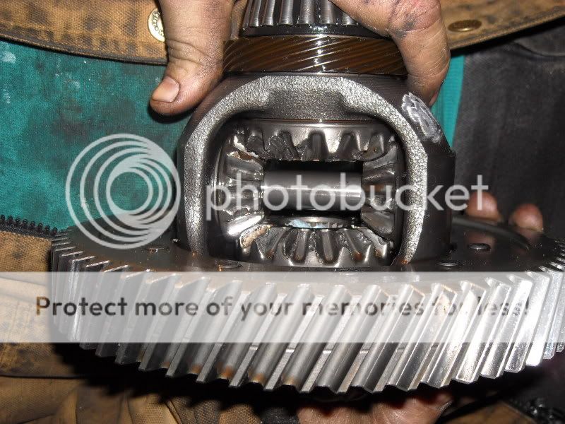

Yes pre 98 diffs are supposedly stronger, however, time and convience is of the essence for him as he is going to be working on it tonight! I have some diffs with under 20,000 miles in perfect shape so he will be more than fine.
Jeff
uh, I call bs, my 98 came with the cut gears early type diff. the spiders didn't chew up like a PM diff, but I snapped the cross shaft between the planet gears. that was with a poorly maintained 160k mile se 2.5. maybe 160hp? imagine the fun with 220?

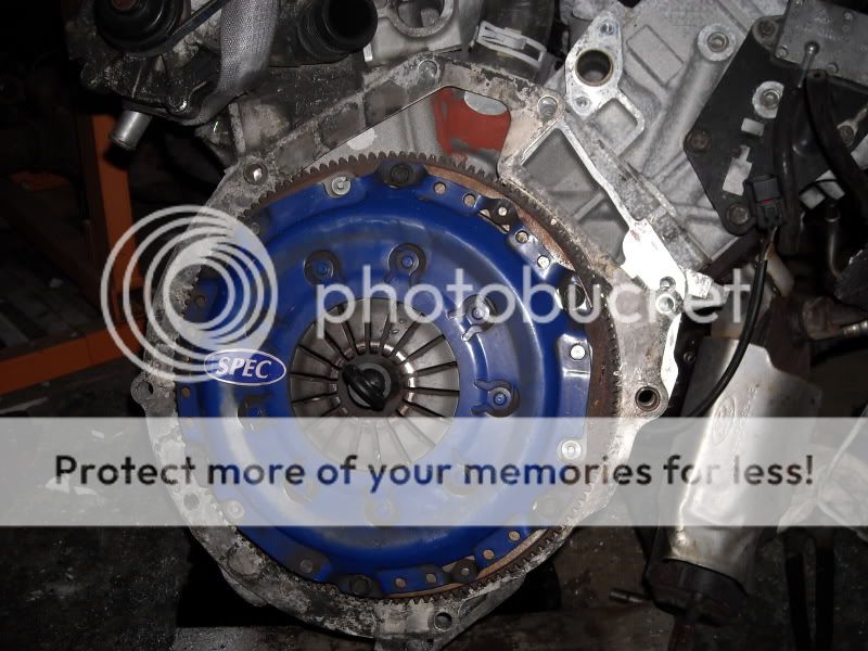

(new) used Spec Clutch
blown up diff (almost)

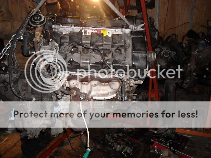

exhaust manifolds installed

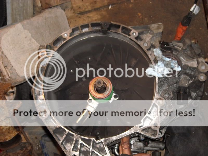

New(used) slave cylinder/throwout bearing
