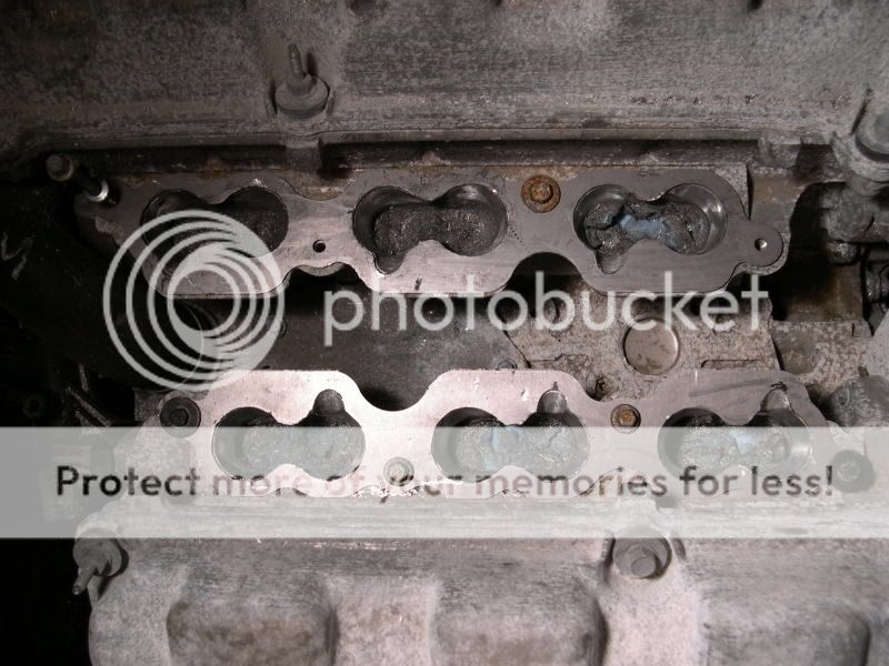

well anyways more of the same glad it is over with. nothing like bending porting bits and having them jump out of the ports and fall out of die grinder. Up next Pulling the engine can't avoid it anylonger.:rolleyes:
WTF, are you talking about?!?
he used farking SOS pads to stopthe Al shavings from falling into the head... WTF, am i the only guy who knows steel wool drops a ton of STEEL debris?
shop rags would have done just fine
really? this is what I have...
Shot with Canon PowerShot SD400 at 2008-10-27
Are you on a monitor from 1980~!>? Its a blue :censored::censored::censored::censored:ing rag in there with shavings caught in it!
Why didn't you put grease over the shop rags??? :confused:
The shop towels are ok by themselves but really wouldn't trust them soley. Pull the towels out when the motor is upsidedown and be careful and make sure all ports are super clean.

ahhhh, I thought it was blue sos pads with that blue soap... sorry.
I did use disc brake wheel bearing greese I made to smear all over the rag especially where it met the port walls hence why all the filings are stuck in there after vacuming.
I was wondering how I would get them out without getting junk in the ports turning the engine upside is a good idea after I clean up the gasket surface I'll have to try that.

Thanks glad to be done with it. I borrowed my Fathers in laws die grinder and bits and he had a great one that made short work of it. still a pain though all the other bits were slow as h*** and the drill was slow too.
I did indeed use blue paper shop towels from AZ all my shop rags are dirty and I feared too large. there are still filings in there because of the wheel bearing grease being so sticky. and I did get the bits into the shop towels a bit
