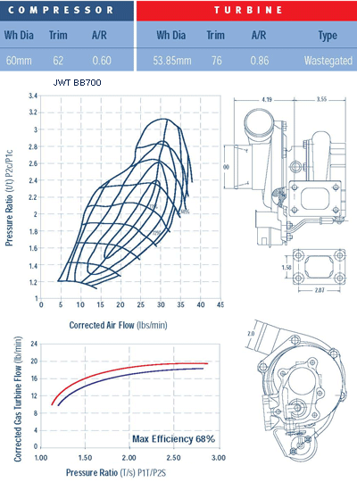

I just found the graph to the turbo I was talking about. There are more options. Some are better than others.
