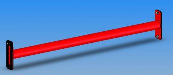

Took measurements yesterday and I'm currently working on a design. Hoping to have a working prototype by mid Aug.
First crack at it. Shouldn't be to bad to build a jig and put one together. Just need to pick up some raw material and test the waters.

Haven't completely decided yet. This initial design will allow for both with minor tweaks. Although I personally am leaning towards the bolt in for the end plates with no pivots. This will allow a quick disconnect for removal of the brace in just a few minutes ideally without tools, freeing up space to allow for larger items being placed in the trunk. However right now that is just a concept. I want to make a working prototype before I start to tweak things for ease of removability. I'm going to try to design such that it is high enough were it really isn't digging into the trunk space to begin with, which is why this first design has it actually sitting on top of the towers rather then just spanning between them at a lower point.

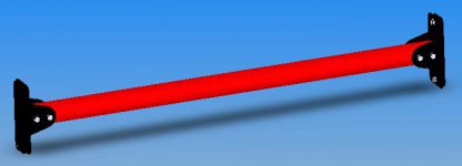

Alright people I have materials sitting here at my house now. This thing is getting done. I have three designs I'm going back and forth on. Each has it's advantages. I'll post up snap shots in a little while. One is simple and cost effective, the second is complex but allows for more trunk space, and finally the last design allows for the bar to be removed fairly easily with a couple of wrenches, but adds complexity and cost. However all of them are stout and much better then anything else that has been available in my opinion. Stay tuned...
Alright guys here is what I came up with. They will all install relatively painlessly. Only requires drilling four holes, which will be pretty straight forward and easy to ensure they are located properly. I found a pretty fool proof way of doing this. Here are the options. I'm personally leaning towards #3. #2, if I pursue it, will require a little more work. I'm not sold on the mounting of it, but it will open up more of the trunk letting things pass through the rear seat opening. Brackets will come powder coated black. As for the cross bar I'm thinking I may offer color matching. Looking for thoughts and comments before I start building PD assemblies.
#1
#2
#3
