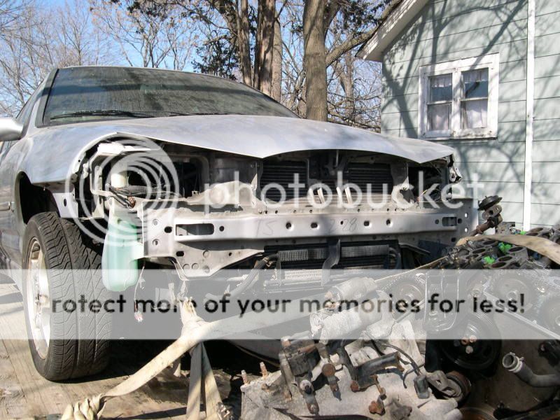

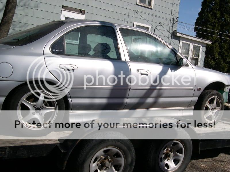

Starting a new 3L here are some pics of the car blown motor already disassembled.
Engine Bay

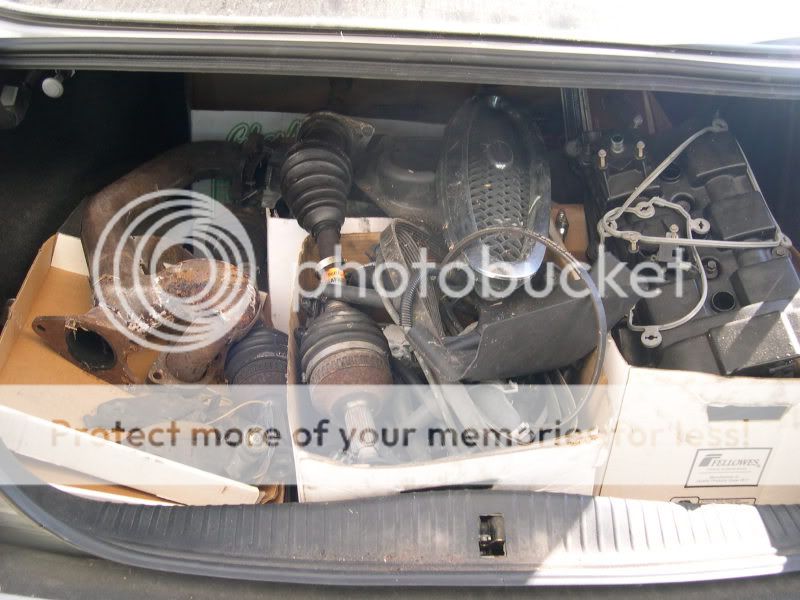

Junk in the Trunk

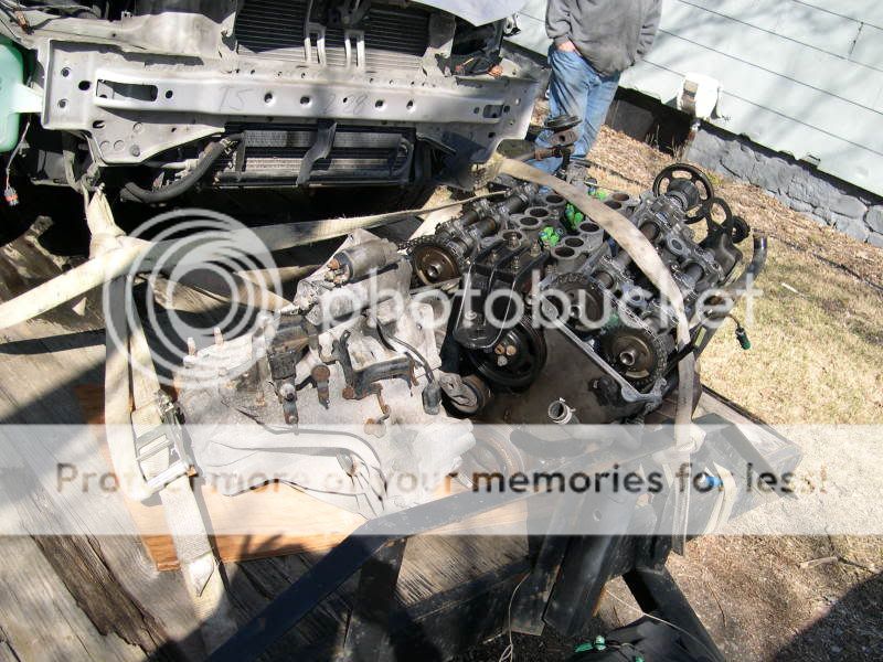

Engine and Trans

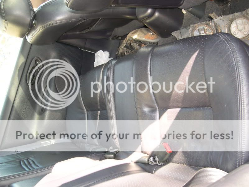

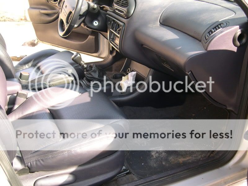

Interior Pics
Exterior
So yeah got an 05 3L Escape engine I thought I might try a full 3L this time around. and now that the weather is better I'm hoping to make this one look a little better than the last one... but still stockish.... we'll see

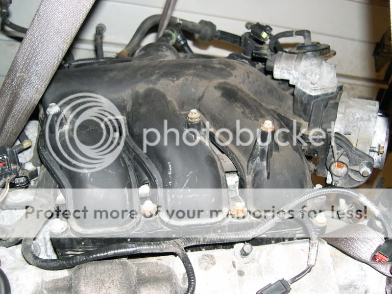

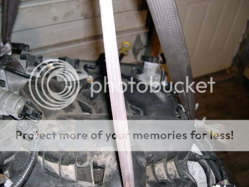

05 Escape intake pics.... and 1 04 taurus for reference.
I just compared the build dates of my two 3L engines the 04 taurus was 03-02-04 the 05 escape was 03-25-04 how ironic......

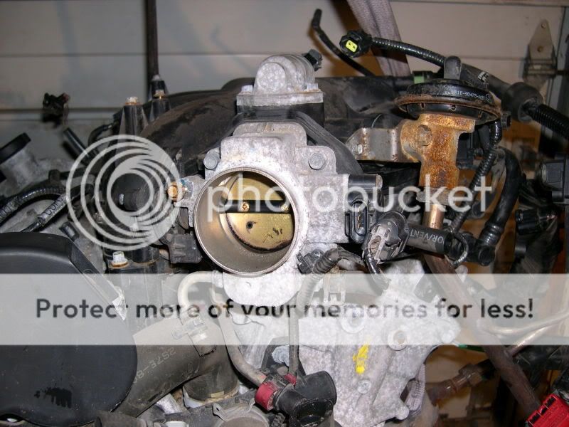

here are the intake pics they look different than the taurus stuff and IMHO much better....
05 ESCAPE
04 TAURUS
well any how we shall see how this shapes up as the escape intake is different than the typical taurus intake on full 3L but it may be a better intake and I like the way it looks better just concerned about the throtle cable position.... may not be able to work. luckily I have a taurus throttle body so maybe that will fix it I don't know...
I know the evap line is like right behind the iac, sticking up in a strange way, and im willing to be it will require a remote iac, but i know it's been done. idk if the mazda 6 uim is the same, but from what I understand, it's the best, and i plan for one in the future. that is unless joey can get that little blower project squared away first, tee hee
I heard that the interference is with the vacuum hoses coming out of the rear of the intake...
one of them has to be blocked off for sure. your IAC won't clear the hood. actually, i'm not sure the thing will clear a stock hood at all.
either way its a lot of work just to get maybe 1hp over the 05 taurus.
for all that pain, might as well fork out for a st220 mani
Or I think I'll just go ported 3L again my old friend
