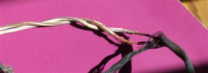

Bench measured my second TSS I bought, figuring the sensor was it, sensor reads ~700-800 ohms on newer style. Then I decided to measured at ~104 pin computer connector between pins 76 + 84 and was getting different readings (connector removed from computer). I moved the wires starting at sensor going back to computer, noticed the resistance was changing. I decided to strip the cable harness and look at problem area. Found the wire insulation cracking everywhere, see photo link below. The wires actually came apart on me, <I'm PO'd>! That may be your problem.
Now I'm going to rig a shielded two conductor from the sensor back to computer harness. Note, I've got to connect ground shield back at cpu end. Do not connect other end of ground near sensor to anything. Shield reduces noise on signal wires. Not connecting one end will prevent ground feedback noise on the signal. This will resemble original factory grounding.
EDIT: The rig worked!!!!
Anyone know the TSB and ability to receive a new harness for free if I show the chafed wires I have?

F!!!! I'm really PO'd now! 3/10 was my 10yr to get the wire harness replaced (99m03). 2 days ago I could have gotten it done!!! Now I have to live with the crappy harness. I wish I would have found the wire issue last week. You guys better check your warranty start date ASAP since this issue is covered for 10yr/100K mi.
