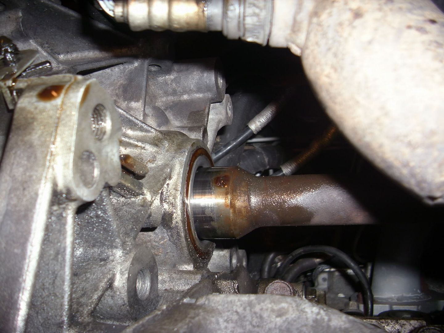

My intermediate shaft bearing was shot - so it walked out of the transmission when the new, much tighter, cv pulled on it while cornering. The snap ring on the intermediate shaft is not on the transmission side, it is on the bearing side. There is NOTHING holding the intermediate shaft in besides the bearing where it bolts to the block - the snap ring at the end just connects the intermediate and the outer cv together.
