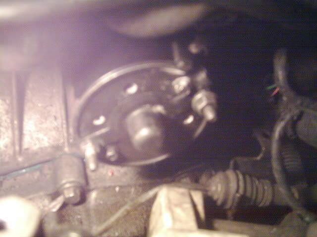

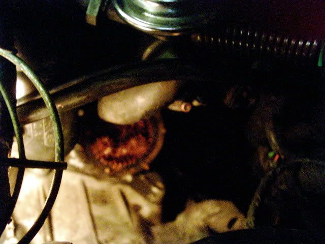

i'm not finding the upper in the way ... it's the water pipes and aluminium plumbing blocking access to the front bolt. ... G.
Ok, it went like a dream. Without the back half of the starter on, it slipped back in much easier. I could reach the firewall side bolt from above and had better sight of the front bolt.
Stage 1
stage 2
hope this helps ...G.
