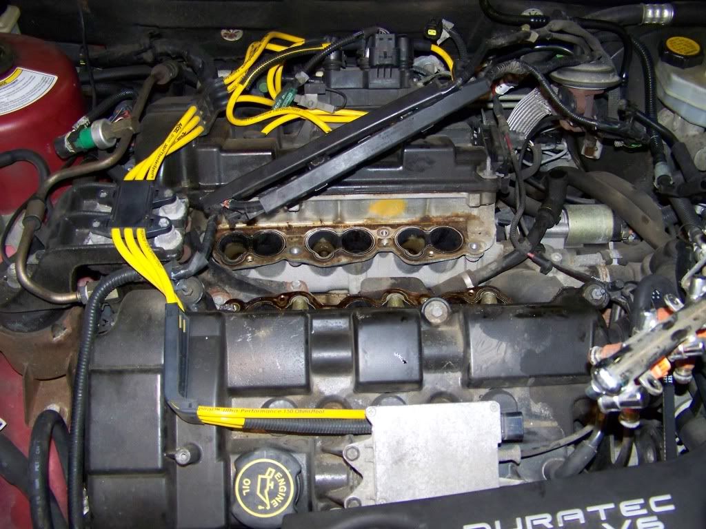

Well...You were right BrApple, I did get a CEL on again... This Time I have 0174 and 0171... Doing some research and saw a reply from you:
[FONT=arial,verdana,helvetica,sans-serif]P0171 - [/FONT][FONT=arial,verdana,helvetica,sans-serif]System Too Lean - Bank No. 1. [/FONT]
[FONT=arial,verdana,helvetica,sans-serif]P0174 - [/FONT][FONT=arial,verdana,helvetica,sans-serif]System Too Lean - Bank No. 2.
Already replaced UIM and LIM. Guess that leave 02, or fuel pump/fuel filter?

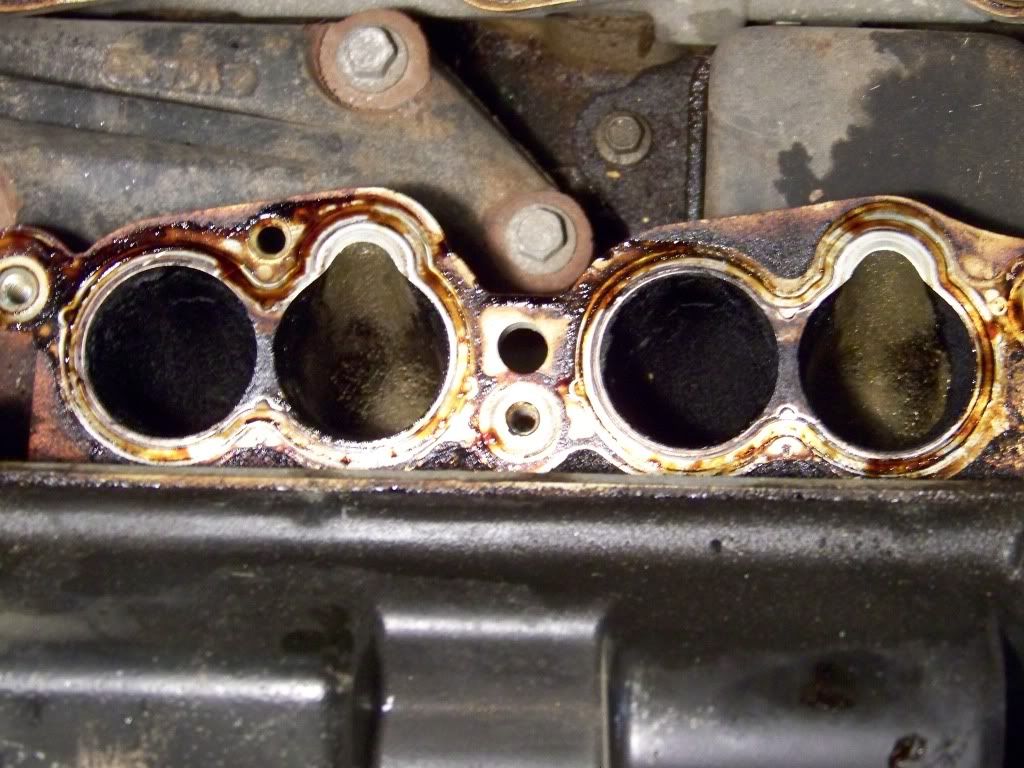

EDIT:
Also found this, maybe leaking at the gaskets I just put on?

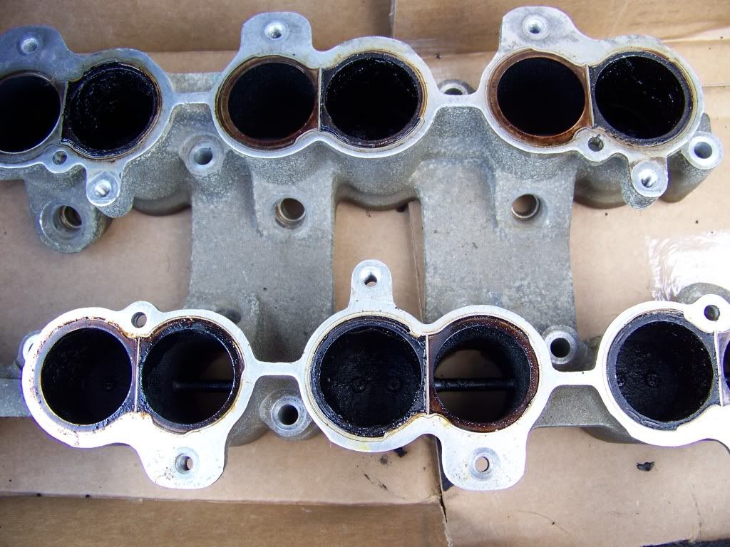

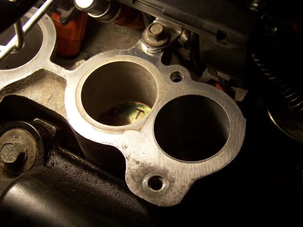

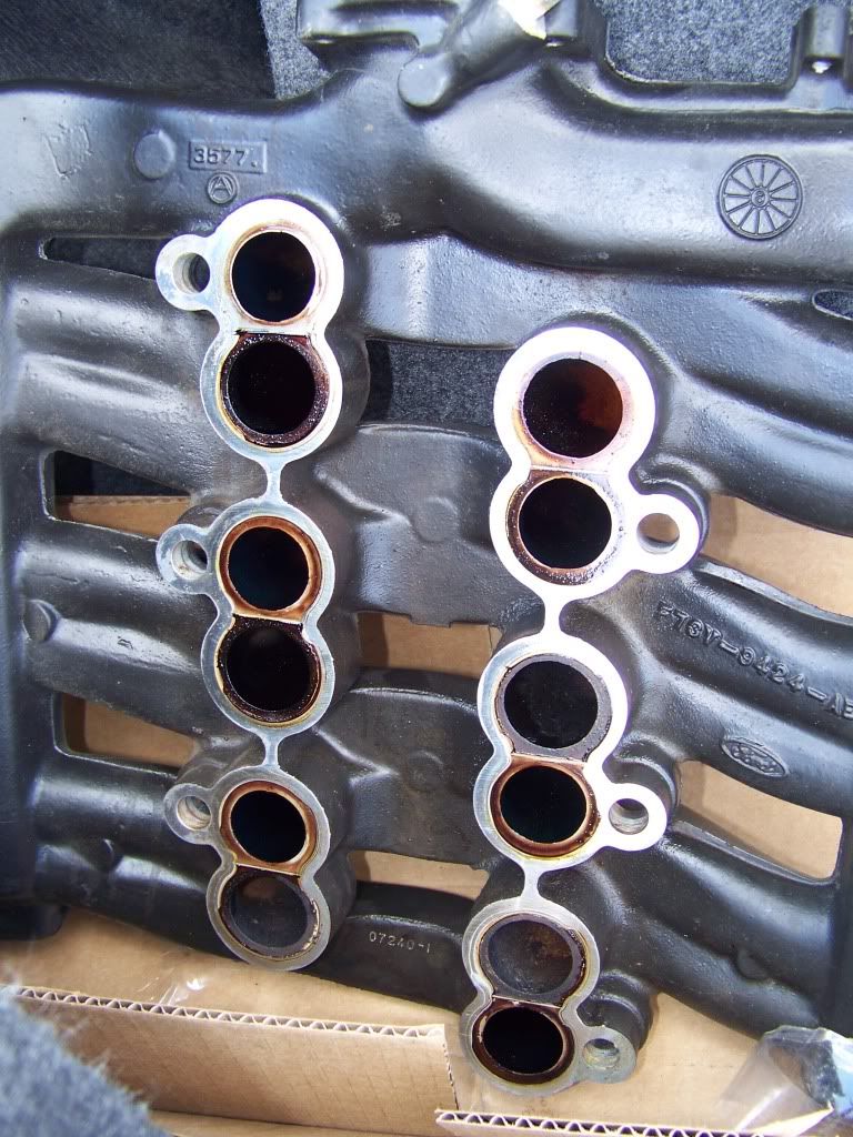

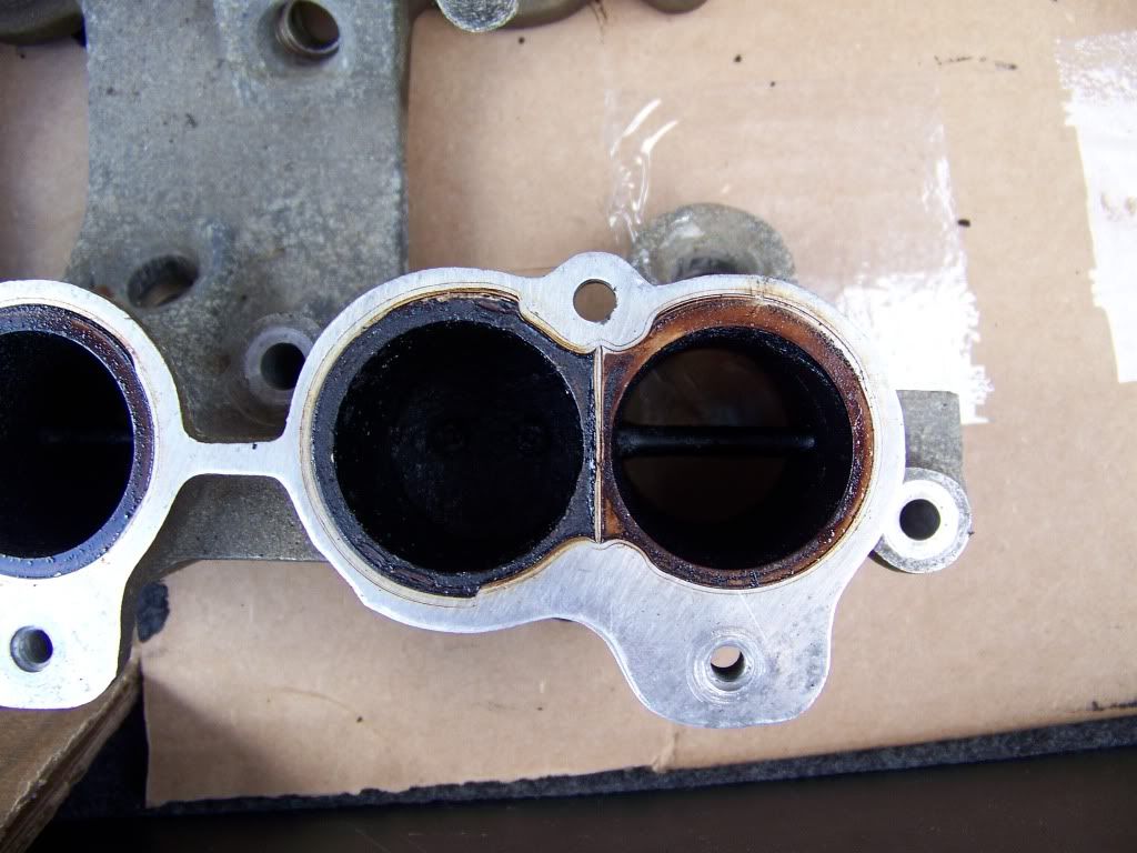

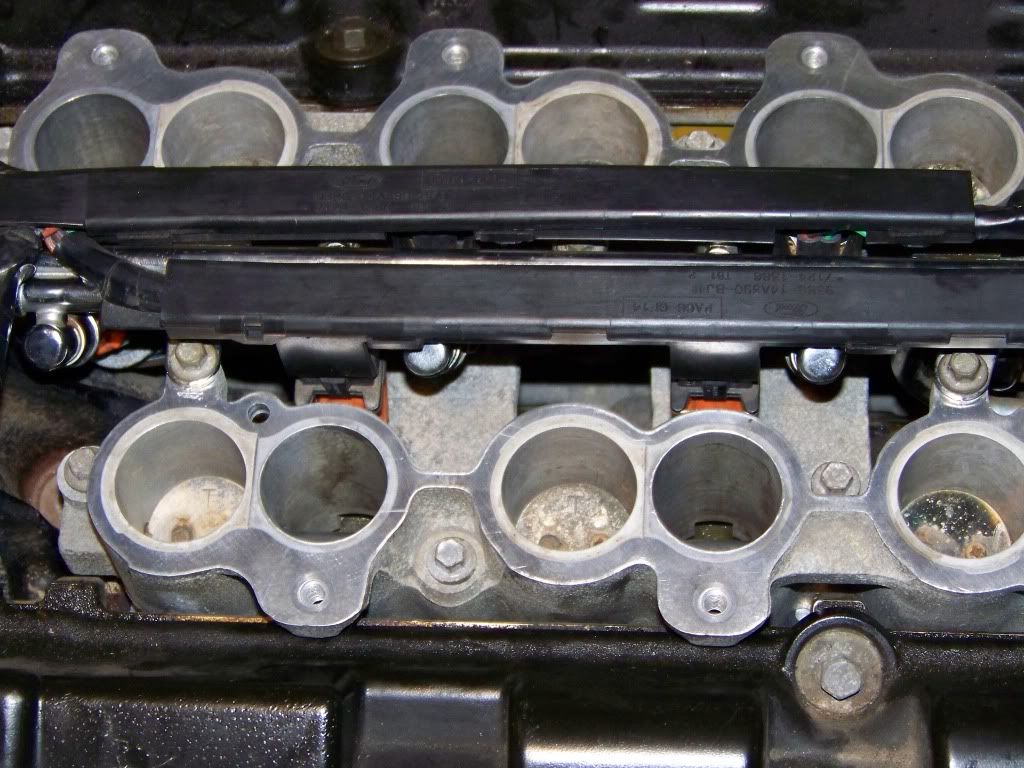

Cleaned my stuff today...
AND BOY, WHAT A DIFFERENCE! The throttle response is great and there is 0 hesitation down low. The transition when the secondaries open is incredibly smoooth
BEFORE:
Power washed in a spray cabinet with a water-soluble solvent. Cleaned up nicely :drool:
AFTER:

Either way, I don't think this is coincidental. After that cleaning and work, no more code and the engine runs very, very strong.
