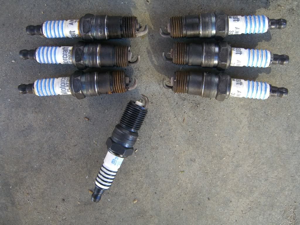

Just pulled the original Motorcraft plugs w/121k from the CSVT I just purchased:
They were gapped around 0.075-0.080, but still working :crazy:
Those look like they have beaten up bad lol.
You will def have a better idle and a little bit of a gas mileage increase.
Wasn't my first time working on a Duratec, but first time doing spark plugs. I didn't have to remove the rear coil pack and with the right tools (socket that holds the spark plug) it was only 45 min to do the whole job.
I think the hardest part was removing the plug wires because they've never been off before, that is until i got wise and used an adjustable wrench to grab the boot. :blackeye:
Kinda scary removing spark plugs for the first time on a 9 year old car, but I did it with the engine cool and put anti-seize on the new plugs. Next time should be a zip.
