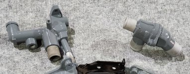

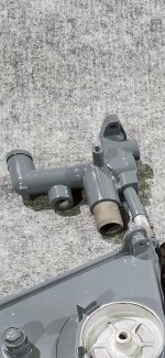

These were so bad looking before. Went with smoke grey. Looks so much better.
![20240520_212436.jpg 20240520_212436.jpg](https://www.contour.org/forums/data/attachments/13/13478-a8decb81226762569176e1d3915bb386.jpg)
![20240520_212219.jpg 20240520_212219.jpg](https://www.contour.org/forums/data/attachments/13/13477-b355db448e87b729ad17aadce2c44053.jpg)
