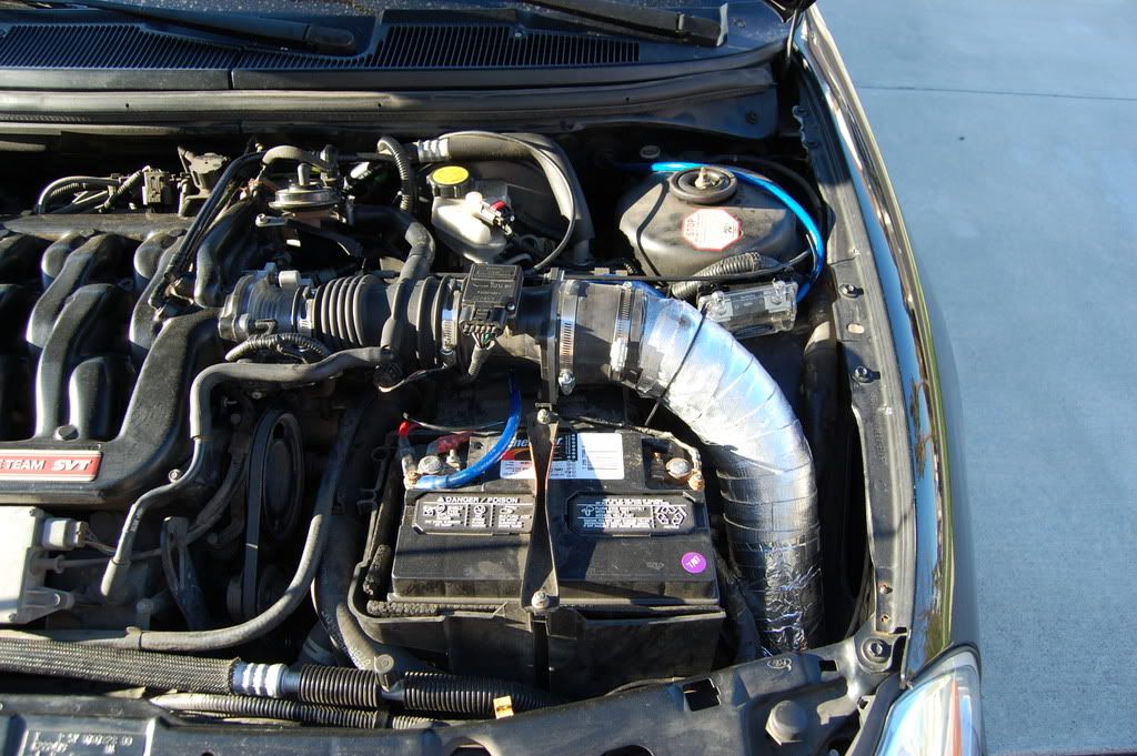

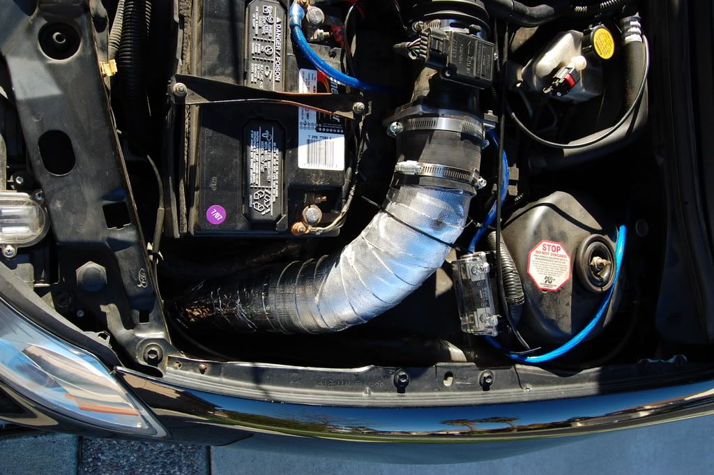

I fabricated this before NP came out with theirs. I've always had cold air intakes on my cars and I was frustrated by the lack of one for our cars. I used a BAT MAF adapter, a 3.5" silicone adapter from ebay, a 3.5" U-bend from Summit, a K&N filter with a 3.5" opening, and some insulating wrap. The fuse box was rotated to underneath the MAF, there was just enough room to make it fit. The next time I take it out to clean the filter i'll snap some pics of it out.
