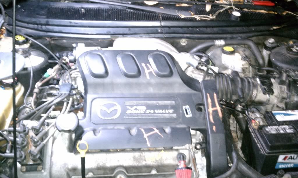

just a few pics of the Mazda MPV 3L installed (taken at night, just after a really bad thunder storm)
Top view on 3L installed

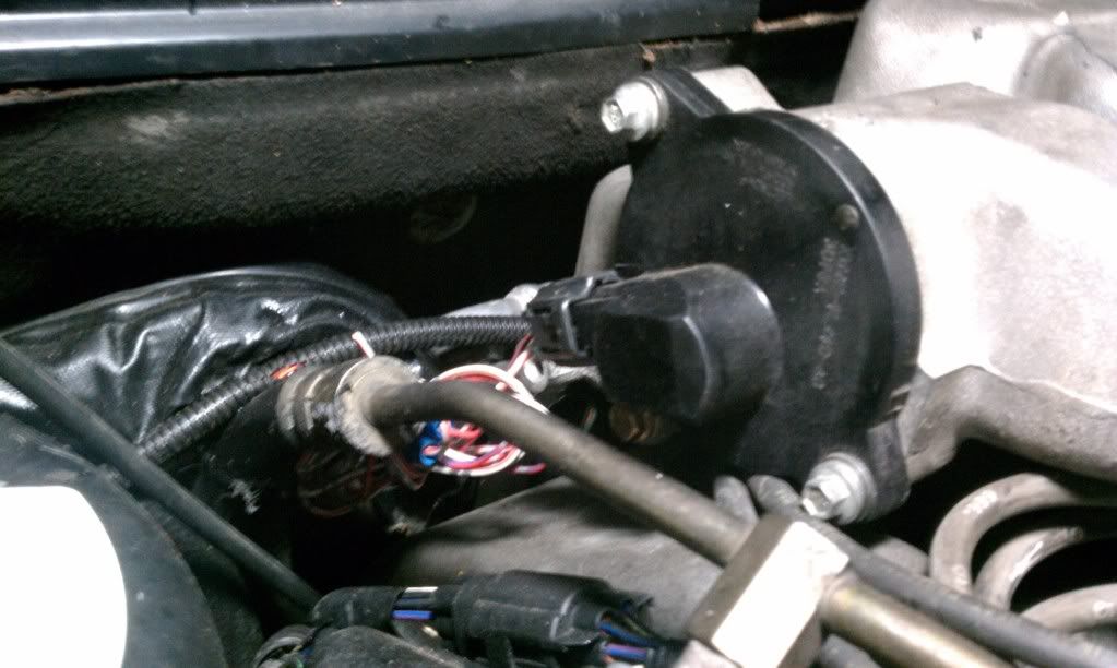

Mazda's MPV 3L UIM's butterfly valve hooked to my WOT switch (for now)
