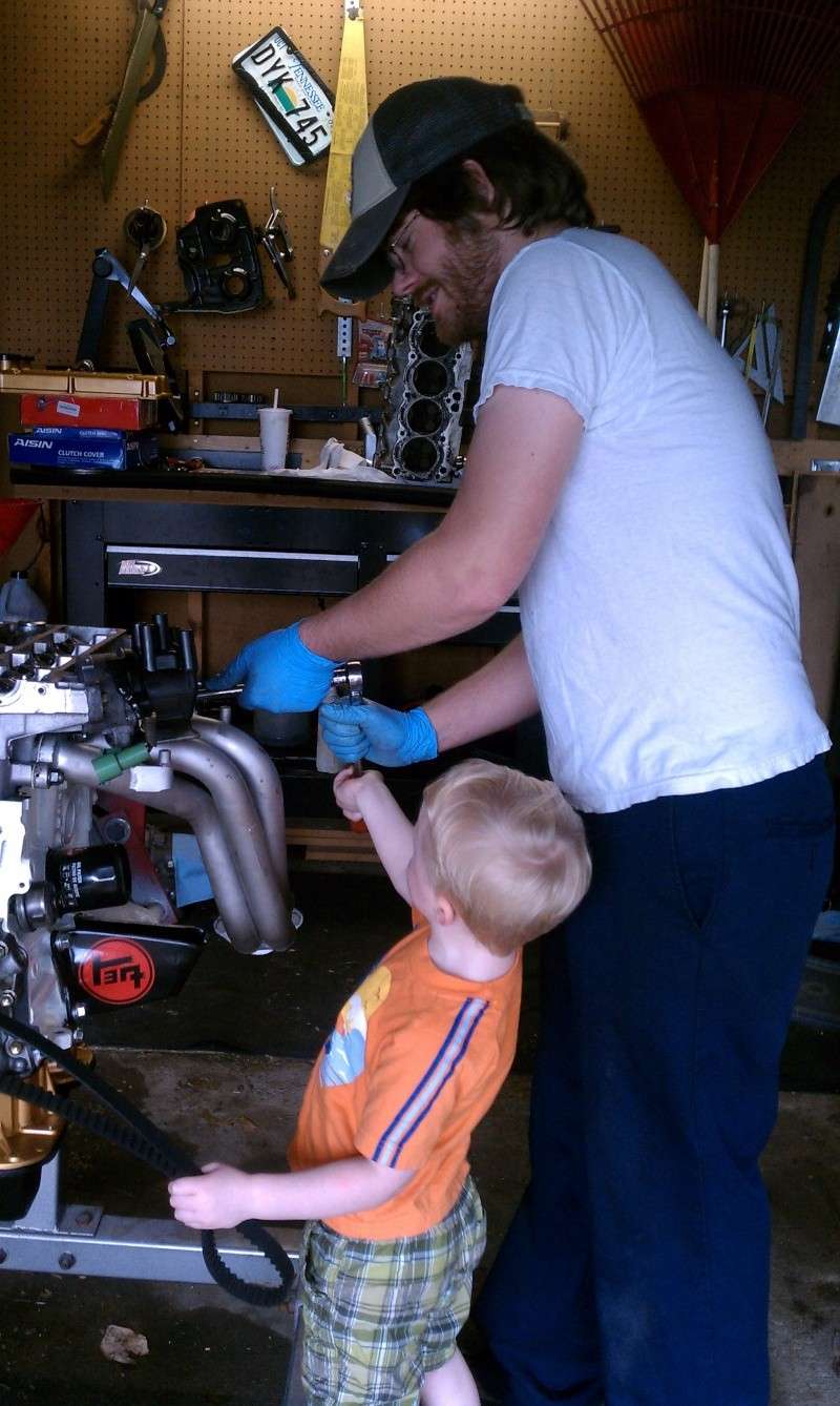

Thanks. Finished the engine today. Just need a hoist to install the flywheel, clutch, and trans, then set on the car.
I'm thinking about taking the inner timing cover off since I have my gears adjusted to where they need to be. I am also planning on wrapping the header in white exhaust wrap.
And don't get it twisted, the dirty head standing up on the work bench in the last pic is for parts. That's not on the motor. So a little run down of what's up:
7AGE hybrid engine
Ported blue top 4AGE head
Bored and stroked 7AFE bottom
Mikuni 44phh carbs
TRD intake manifold
OBX exhaust manifold
MSD 6AL
all new seals and gaskets
