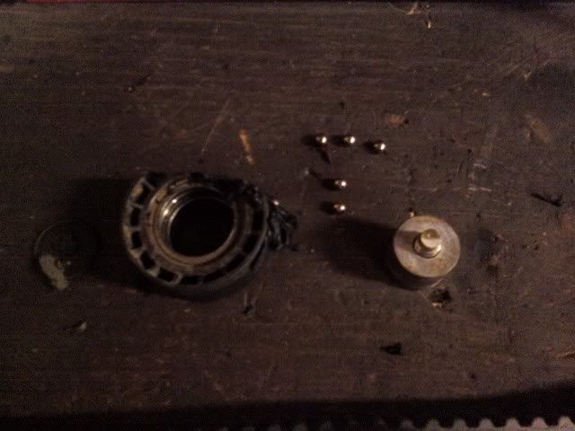

Bahahah! Cam alignment tool :laugh:
I think I ruined that idler... :laugh:
Looks as though the idler was seized up. It's all worn away to nothing on one side. :shocked:
Mine was worse... Alls that was left was the middle circle of the pulley and the bolt into the block.
Hopefully you get it up and running again.. Good luck.
oh its back up and running I am sure by this point. I don't think Ian would have posted pictures if he didn't get home...
Hey, that looks familiar! Same thing happened to me. But it happened right after Ford "fixed" my timing belt and pulleys. :help:
The other pulley was also about to seize, FWIW. Bearings were grinding like MFers! The tensioner/pulley seemed like it was still in decent shape, however. I'm still unsure whether or not this timing belt and the pulleys were original to the car (113k), but I DO know that the timing marks on the cam gears weren't even close to anything important, lol. They pointed to nowhere :laugh:. We didn't need the marks, just the alignment tool (if that). As long as the crank pulley is on TDC, you pull the belt up around the front cam, lining it up so the cam goes to TDC, then pull it around the other cam (which can be tricky, we weren't sure at first which tooth it should go on), then down around the tensioner.
