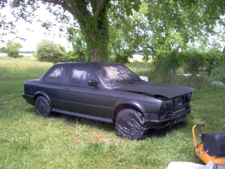

I found out why the bedliner turned out like horse :censored::censored::censored::censored: the first time around. I did it on a 90 degree day in direct sunlight.
I found out sanding it down wasn't plausible right now since I don't have 2 weeks to devote to it...so I bit the bullet and spent another $71 on 1 gallon of the same crap I used.
With it being in the shade on a 70ish degree day it went on 3000 times better. The finish seems MUCH more uniform than the first try. It's still a little rough...but it's not bad at all. It's probably as good as it'll get considering it's a roll-on application. I have a few plastic pieces left to do, but it should be done by Monday or Tuesday.
I decided that I need to go over the truck with maybe 100 grit BY HAND (the sander would ground out some spots on me) to get the really rigid specs out. Then probably rattle can some flat black over it.
The hood came out the best, and that big blotch is actually dirt or wiper fluid.
