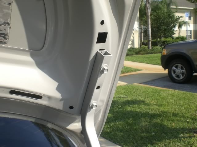

There are no "hinges" so to speak and what is this talk of glue?. There are steel tubes that pivot up and down and are support by struts. These tubes have holes which bolts pass threw and thread directly into the steel frame of the trunk lid. The trunk lids steel frame has four (4) tapped holes.
So the question is how are you going to put these tapped holes into the carbon fiber trunk lid.

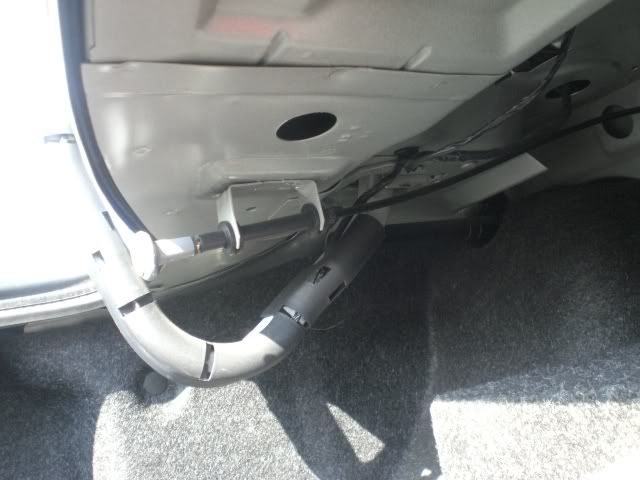

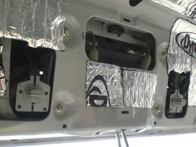

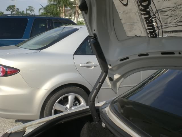

Can someone get me a picture of under the trunk? That would be a great help in getting me on the same page as everyone else.
Thanks
Justin B
Here are some pics I just snapped. Sorry for the Dynamat. I think these should put you on the same page. I think the main question was how these are going to be made; how many layers of CF, will there be a core, will it contain fiberglass or will it be all CF? Refer to the post above yours for the rest of the questions if I missed any.
I didnt know exactly what you needed so I just took pics of everything:shrug:
What we would do is make a 2 part mold(top and bottom). The top would be 1 layer carbon fiber with a backing of 2 layers of fiberglass and the bottom would be 3 to 4 layers fiberglass.
Now what we would do for the mounts would be glue a peice of metal to the bottom of the trunk this way you are not bolting anything into the fiberglass bottom itself. The glue would be just as hard or harder that the fiberglass. Metal bond glue or liquid nails. We do it to the hoods that we make and have had no problems thus far.
That would be the best way I think to make the parts. The metal peices will save a lot of headache in the future.
I agree plus then you would have to worry about overtightening the nuts and bolts and cracking the fiberglass as much.
