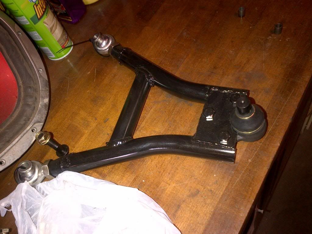

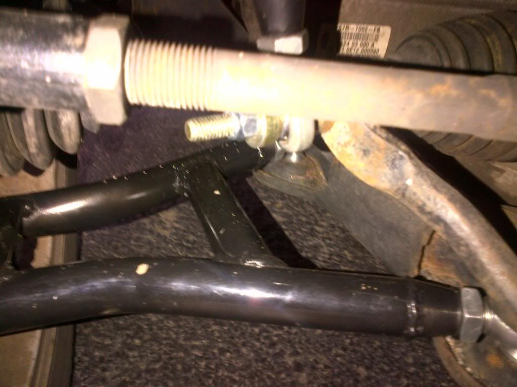

Finally got around last week to make it up to AirCougars to try out the first prototype set of Tubular control arms.
The front end feels a lot more solid then my stock OEM arms that had less then 8K on them.
dont know that im a fan of having the ball joint recessed like that. i was hoping to have a bit straighter going into the sub frame so that you could get some camber out of it. might be able to get some caster out of this but thats not what the front needs
Preface: Just some observations from an old suspension hack, not an attack.
Indeed, an arm with straight entries into the subframe pickup points would give easier and wider adjustability of camber and caster. The angled entries for the rod ends makes it more difficult to align, as the center-to-center distance of the rod end balls changes with even small adjustments, and this distance must remain constant.
The biggest issue with a straight entry a-arm would be clearance to the wheels at full lock, haven't measured this on our cars, but in eyeballing it, it doesn't look like an issue unless you're running stupid-wide wheels, and even then, the tires would probably hit the inner fenders first.
From a rod-end standpoint, make sure you're using high quality, high strength, Teflon-lined ends, Aurora and QA-1 come to mind. This is a mission-critical suspension component, if a garbage grade rod end breaks, it's going to ruin your day.

Having adjustability at the bottom just increases the chances for pinching the cv together. Or at least the amount you need adjusted.
Maybe, but having the ability to add a few degrees of negative camber for a dedicated track car wouldn't hurt, unless you're willing to do this:
Now, if you screw out the rod ends on the Stangkiller A-arms to try to increase the negative camber, the ball bores will quickly get too far apart and they won't fit the hole spacing in the subframe, so, due to their design, you're pretty much stuck with the geometry they're built-to. I suspect the fellow who builds these knows this, but some folks will look at these and think "Oooo, now I can adjust this and that..." Well, not so much, actually.
Yes, you're correct they will not turn much before they no longer align with the holes on the subframe, if you search for stangkiller arms there is a lengthy discussion on the topic. However, Warmonger, IIRC, did some quick calculation and came up with a .75 degree change in camber with only a 1/4" change in length, which is very substantial.
However, I'd personally be happier if they were made slightly shorter to allow for enough change in camber to correct the negative camber I'm experiencing as a result of the lowering, I ate through the inside of my drivers side tire (BF Goodrich G-Force Sport Comp 2's, 340 treadwear) in roughly 1,500 miles, and the passenger side insides are only slightly better.
