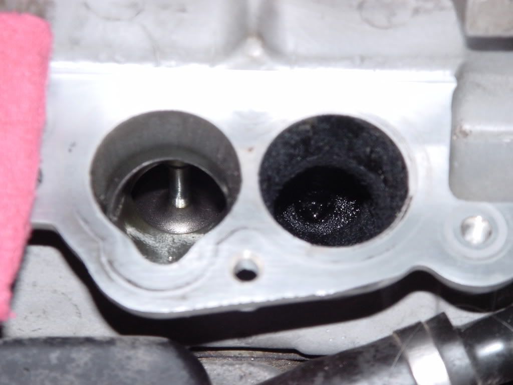

If the engine is in good condition, and top tier fuel (Chevron Premium) consistently used; what causes these to become "dirty" and require cleaning as previously described???
This is pretty typical port appearance for a moderate miles Duratec, this was mine at maybe 70K miles. Can you tell which port has the fuel injector? This car has had Redline SI-1 injector cleaner religiously in the fuel tank since Day One, and I've owned it since Day One.
A hyperactive PCV system combined with EGR seems to cause the intake deposit buildup. Installing a coalescing oil trap in the main PCV line to the intake seems to help, I did this some time ago and it has greatly reduced the buildup of PCV related gunk on the back side of the throttle plate, but I haven't had the intake apart again to see if things have stayed decent after I cleaned it all out some time ago.
