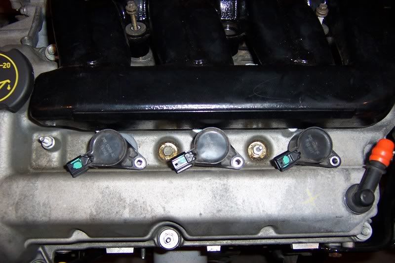

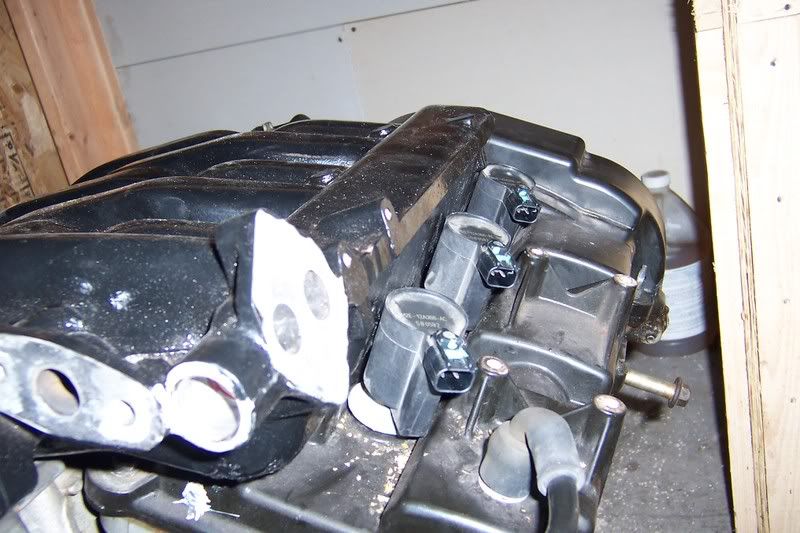

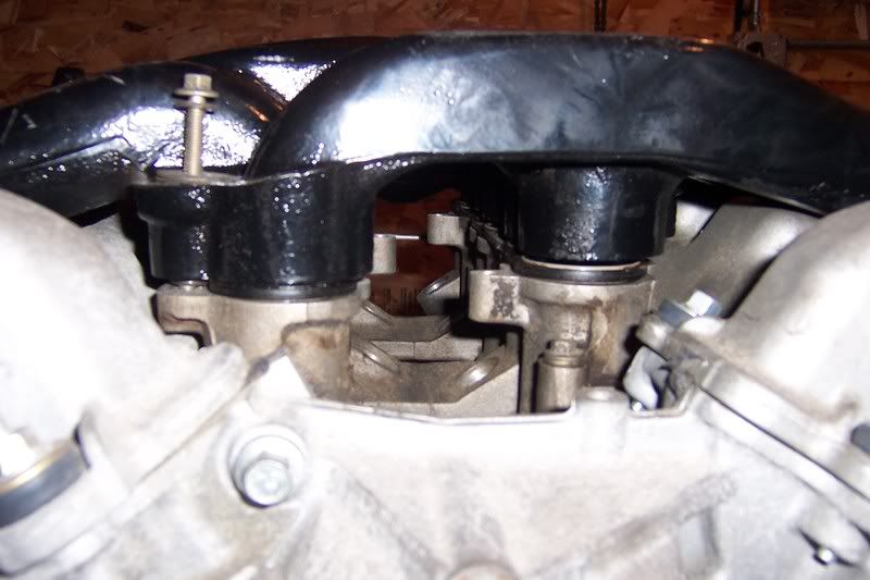

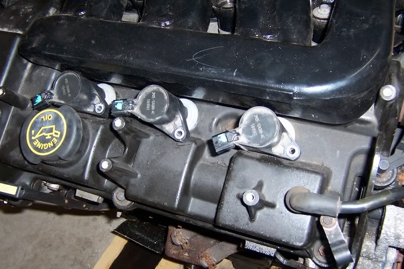

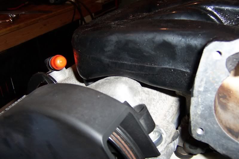

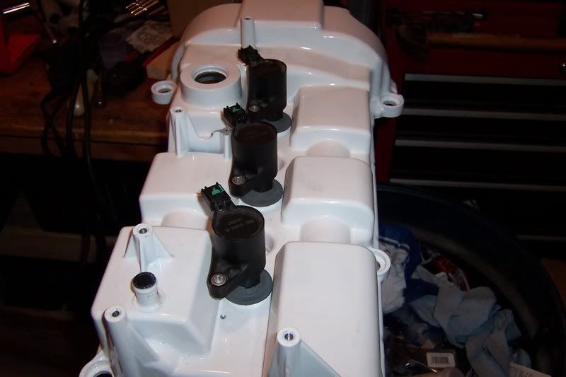

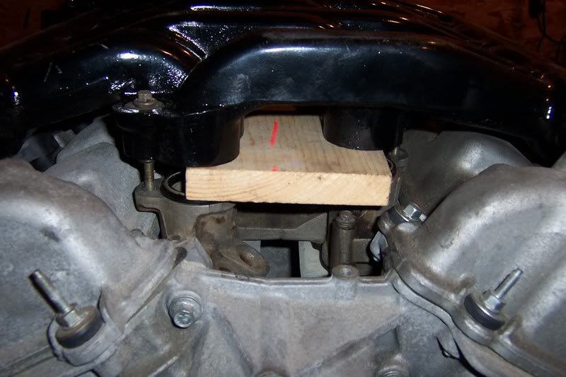

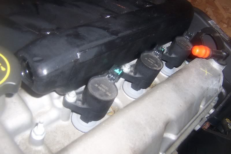

Spent some time at the shop tonight after work, and From what i gathered, to make everything work out, would take roughly a 3/4" spacer, wich i would have CNC'd out of AL, and o-ringed on both sides to completely eliminate the UIM gasket. You will see this arise in something else i've been working on.

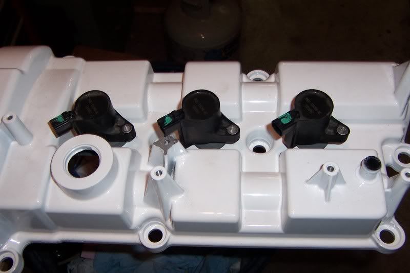

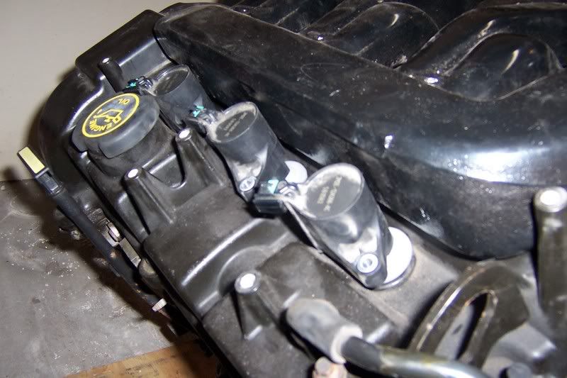

Now, what i did discover, is that with the fron coils rotated 180, because they're off center tehy move away from the UIM and it would bolt up in this manor if it didn't interfere with the Valve cover as shown.

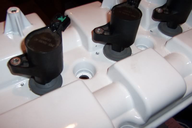

Now because my plans also involve some other changes to the engines components location and function I'm going to stay away from the plastic manifolds. After some measuring and comparing, I will instead be modding the stock 2.5 VC's so accept the COP units. Pics follow of current design concept. There is really nothing stopping me from making this work at this point. The VC's will not be tapped or drilled as shown to mount, this is just for mock-up.
Is there a noticeable advantage to using COP? Honestly, I've never had a problem with the coil pack on any of my V6 SHO's, but the V8 cars (basically 2.5L duratecs with 2 more cylinders) are always cooking the rear coil packs. I haven't checked the prices of them in a long time, but they were pretty pricey the last time I looked.
Dude, that is a good idea! Rotating them and tapping a new hole :crazy:, nice. Should look pretty clean too. :thumbsup:

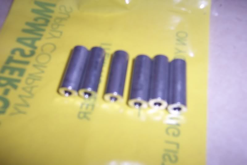

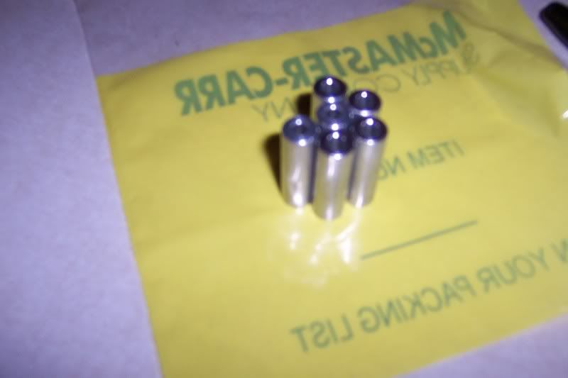

I'm actually using aluminum standoffs that will be welded to the VC and tapped, they should be here tomorrow and i can continue work on the project.
McMaster Carr ownz. Needs more spice rack though. :D
It's at the shop maybe later.
On the McMastercarr note, yes they do own. They didn't have threaded standoffs in M5X.8, so i look in the unthreaded. They have them in the tap drill ID for M5X.8 and in the length i need at a tol. of +/- .005". Even if they don't have exactly what you need, they can typically get you damn close. :cool:
