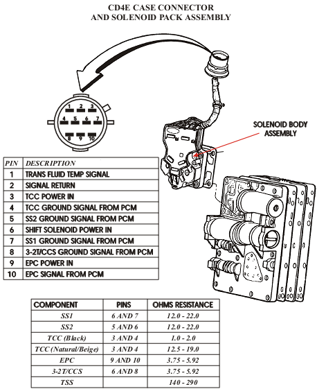

Well today i started checking the wiring on connector that goes to the transmission solenoid pack. I used a multimeter and could only get readings from 5 out of the 10 wires, 4 wires read 11 and 1 wire read 4. Is that normal?
Actually only 4 of them got a reading:
2: 11v
6: 11v
8: 4v
10: 11v
One thing that stands out to me is "Pin 9: EPC Power In" not giving out a reading, considering that the P1747 code is directly related to the EPC. Now if this isnt normal, I would expect the PCM being bad or a shorted wire.

Yeah, I kind of figured lol. Its fine though. I guess it could help others who have a similar problem in the future. Before i started this thread i had zero leads on where to start, Now that i checked the pins in the shift solenoid plug and only getting 4 out of 10 to read, That tells me i may have found my problem. I wonder if a group of wires in the harness shorted out or something and thats why 6 of them aren't showing anything on the meter? The big one is the #9 pin in that diagram above, as that goes directly with the code im getting and im getting no reading from it.

Black lead is on metal(grounded) and red lead is going into each pin hole. Again, 4 out of 10 gave me a reading, the rest stayed at 0, The connector im checking is the connector on the harness that leads to the wiring harness that runs at the back of the motor to the PCM.
Battery is new, No issues there.
Ignition is "on" during testing.
Connector im checking is the connector that goes to the solenoid block(pictured below)
