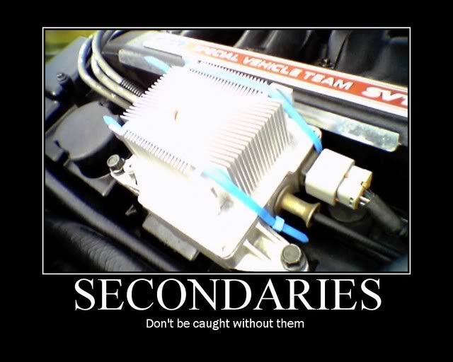

I had this intermittent IMRC function issue.
The unit was overheating (would work until engine operating temperature was reached), I opened, inspected, and cleaned it, but no dice.
I just moved it to the battery box. Problem cheaply solved. :D
She's got her legs back. :o
