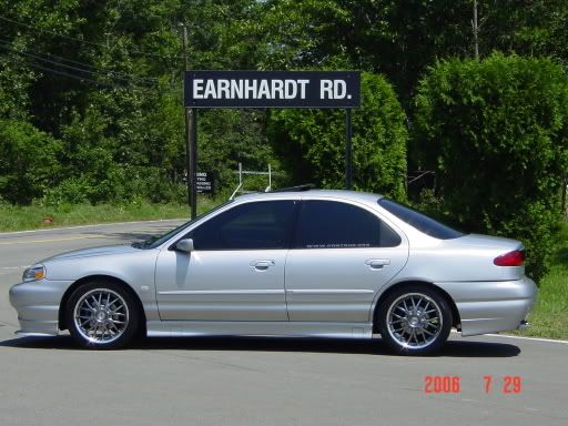

Pictures showing the ride height over the years.
Autumn 2007
Autumn 2006
Summer 2004 (rear weight reduction from previous year pic, lighter sub box, but some weight added back due to aftercooler water storage tank and pump in trunk)
Autumn 2003
Autumn 2001
Observation, the front end on your ride seems to be too high, and that is probably exaggerating the the back end being much lower than it actually is.
My thoughts exactly. Your rear looks good IMO, but your front almost looks higher than stock.
That last pic looks identical to his.
Exactly the point of my post. The last pic is the same day the suspension was installed, but you can see over the years how the suspension settled, longer for me due to the lack of driving. Look how much lower the front is in the more recent pics compared to the earlier pics. I'd say the front end settled an inch or more lower than when the kit was first installed.
