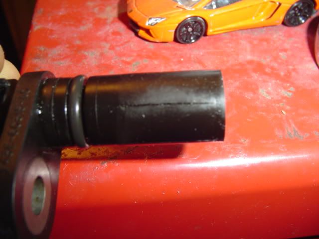

From what I understand the crankshaft position sensor handles ignition timing and the camshaft position sensor handles injector timing.
I already replaced the cam sensor because it is cheap and very easy.
So today I decided to replace the crank sensor.
It looks like it got bigger, splitting the body of the sensor.
The new sensor has a metal body not a plastic body like the stock sensor.
