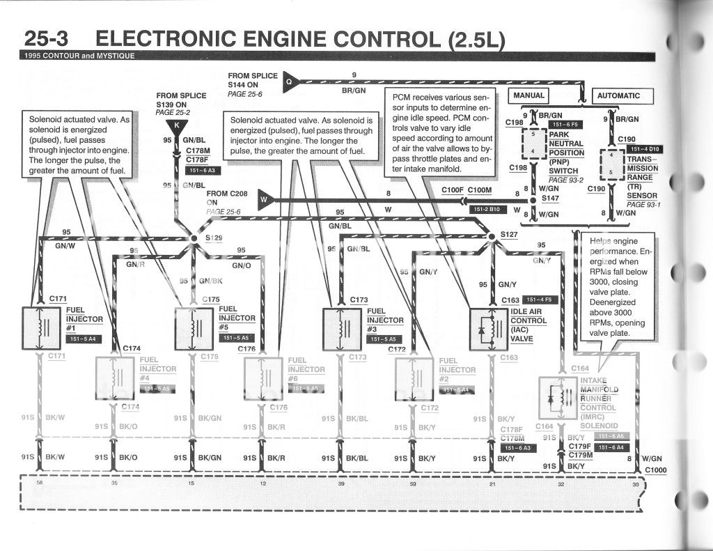

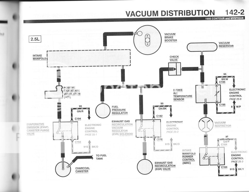

Got the chance to test things. used a different style vacuum check valve with a 7/64 hole drilled through it. secondaries fully open at 4000 RPMs. Haven't done any 0 to 60 pulls , but the kick has returned from the secondaries opening later. Have to adjust my driving style a bit to take advantage of the way it drives now. I still believe that the secondaries opening slower and at a slightly higher RPM will improve driveability. got this week to find out.
This check valve is also found on Escorts with the 1.9 SEFI
