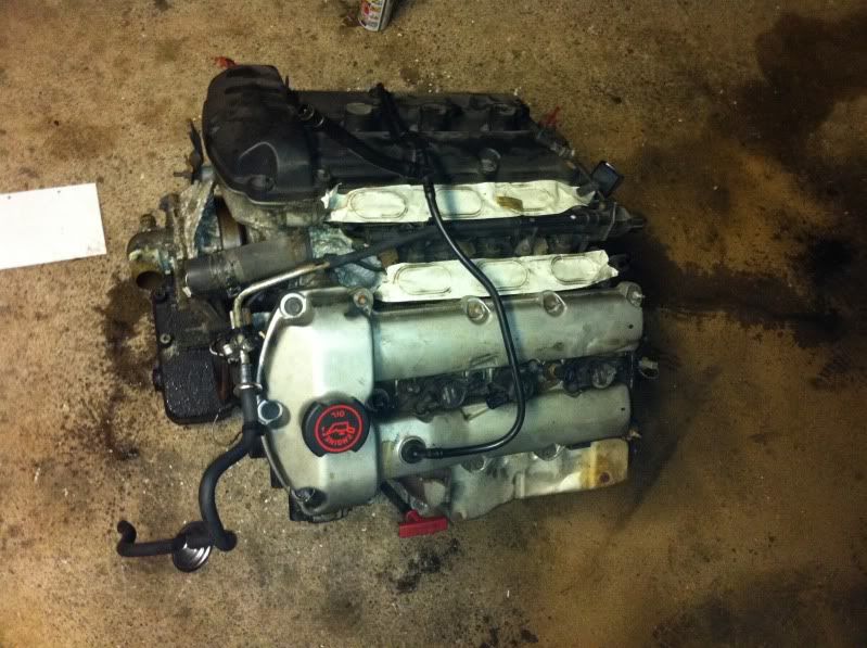

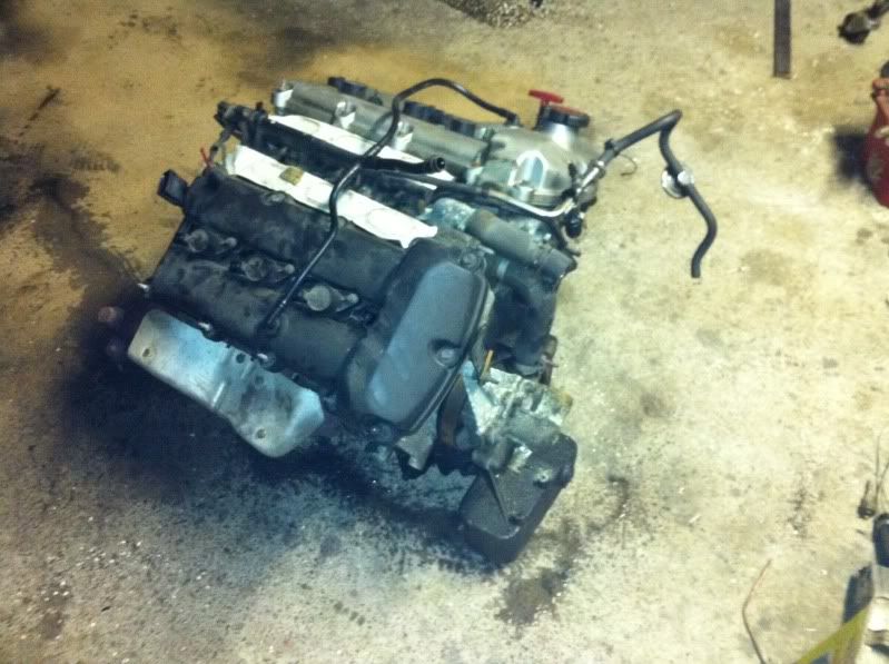

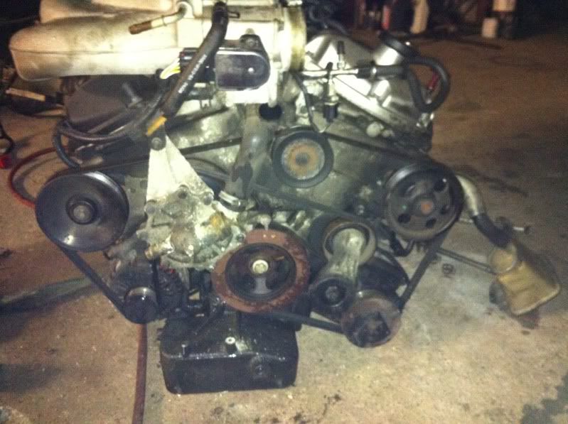

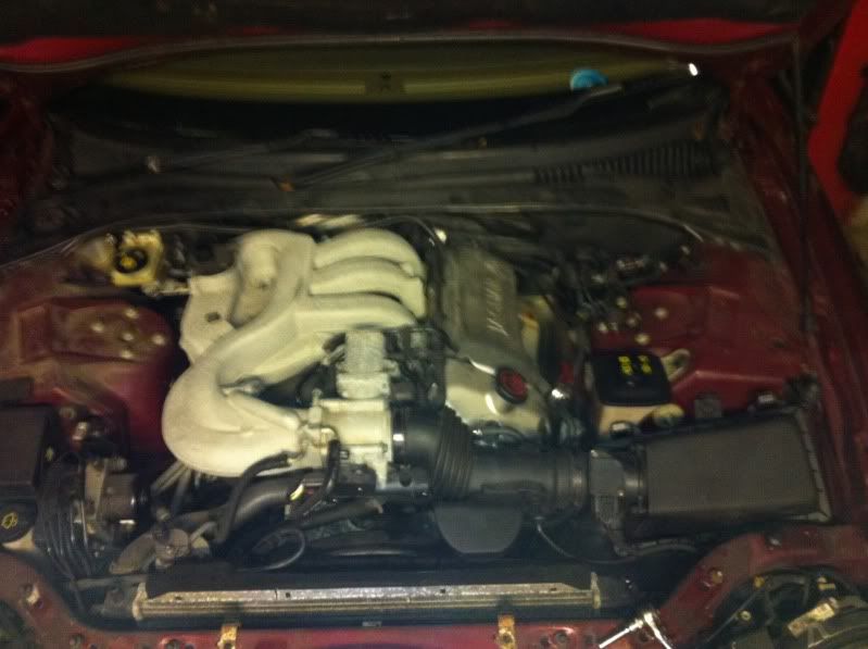

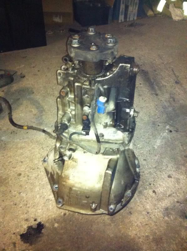

started removing engine from the jaguar last nite, so hopefully have it out tonite

This is the jag I am taking the engine from

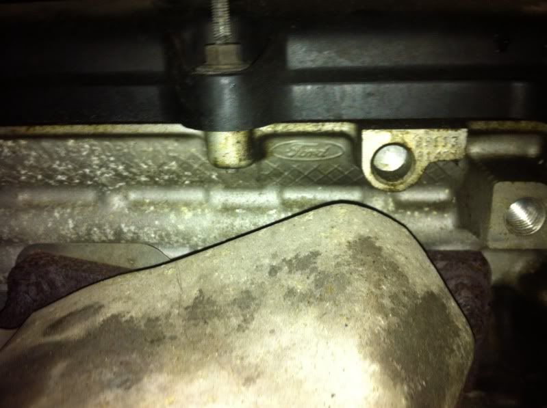

Oh and here is one for yous, they are jag designed heads apparently but still stamped ford on the head casting :-)
