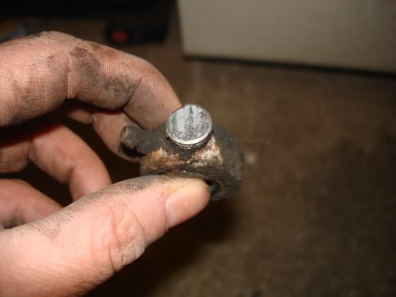

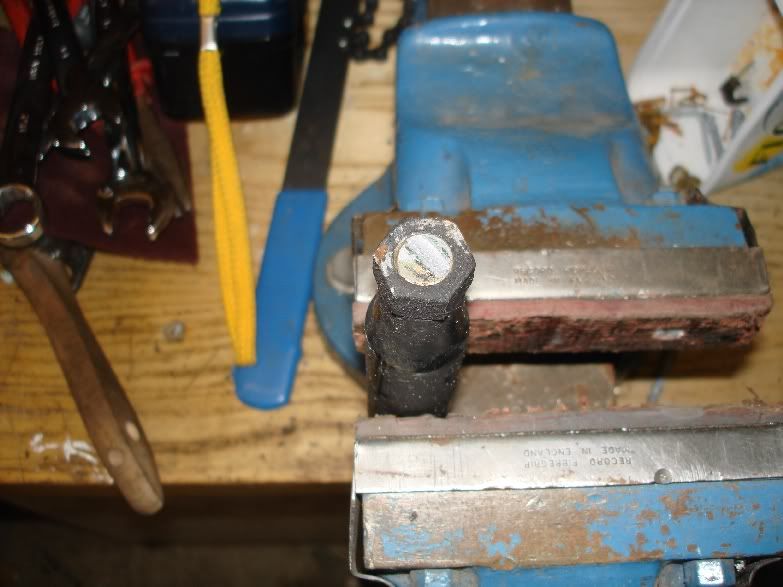

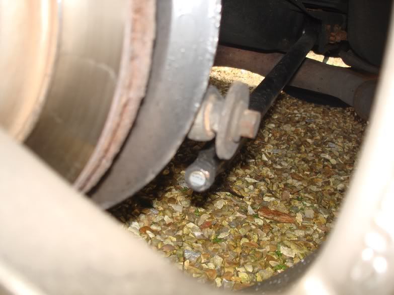

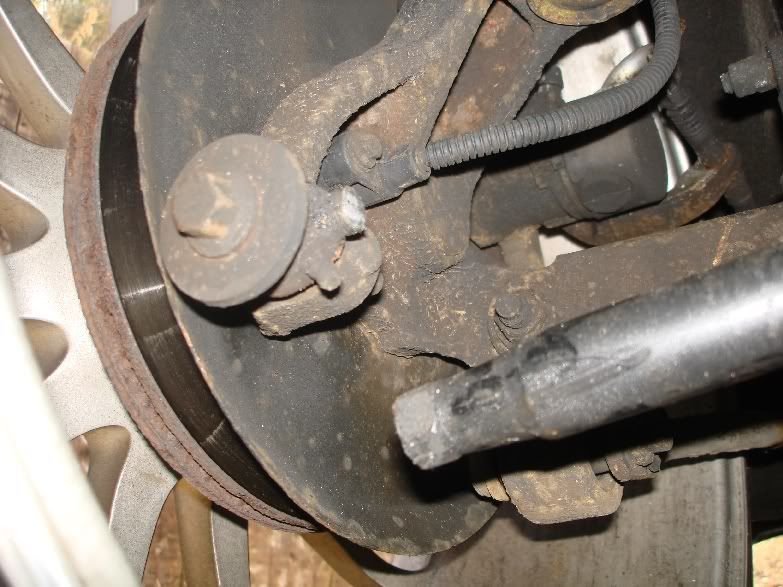

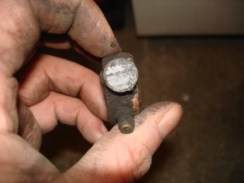

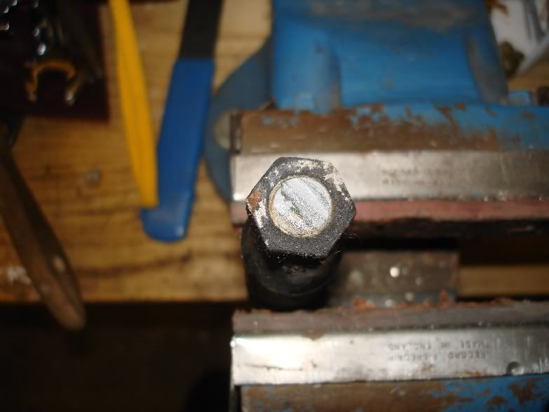

As the title says really one of my tubular rear control arms has sheared at the rose jointed end link. I had a scary 5 minutes in it & it was just lucky I was only doing 20mph as if I was going faster it would have been a different story. Here's a few pics
Rearf wheel steer Mondeo, lol
I went out yesterday & put the old arms back on now so I've just got to get the tracking redone & all should be OK again.
Looking at the where it's sheared the rose joint on the end has seized solid, so is the other side, so I think this is why the threaded bit, where the rose jointed end link goes into the arm, has sheared.
These were fitted last October & the car has done just under 8000 miles with them on. I don't drive the car that hard & I was greasing the arms up every 2000 or so miles so it looks like the good old British weather has taken it's toll on mine & they needed to be greased more often than that. Oh well doesn't matter as they are off now.
I'm going to look into getting a replacement end link for it & then decide to either sell the arms or put them back on & grease them more often but I expect I'll be selling them as I'm not sure I can be bothered to get out there & grease them all the time.
Sheared end link stuck in bar
Sheared end link
Has anyone else heard of this?

That failure is not from road grime or lack of grease - the pivot point would fail before the joint would sheer like that - unless there was a defect in the manufacturing process.

Those arms were designed and fabricated by me. Anyone who isn't a Ford suspension engineer offering an opinion on the size of the rod ends being used is supplying pure conjecture. What load is each individual suspension arm in the rear of our cars being exposed to? The main control arm handles the majority of the lateral loads, not the toe arms.
I have sold over 50 prs. of those arms and the second set of those arms are on my car and have been in continuous service since the Fall of 2003 with more than 40,000 miles on them. My car has seen track duty and is a daily driver in all 4 seasons here in the Great White North. The arms are exposed to a barrage of snow, salt and slush each winter. I have experienced no such failure BUT I maintain my 96 SE (over 200,000 kms) meticulously.
This particular failure was a result of corrosion-the ball was seized in the race. Why or what conditions caused them to corrode is the real question to be answered in this instance. This was not a design failure.
I agree fully that the reason the rod end breaking was not a result of any type if engineering failure. The only reason it broke was due to excessive corosion build up. I simply showed the different specs on the rod ends to show that cromoly rod ends are a good way to go. Yes they are very strong. But the mild steel ones are plenty strong enough for the rear toe link on a contour. The key benefit to the cromoly rod ends is that the sphere is coated in teflon. That teflon will eventually wear away, but it will allow for less servicing of the rod ends. If they are not serviced, they may eventually break too. I do not know if the toe link that broke had cromoly ends, nor do I know what size they were. I was just trying to be helpful. If I was spreading conjecture, that would imply that I do not know my stuff. I may not be a ford suspension engineer, but I know suspension fairly well. I am aware of of the design charactoristics of the contour's suspension, and I know how to tune it for control, response, feedback, feel, ect. In about one months time I should have enough evidence to prove it.
Lack of maintenance, resulting in corrosion, and ultimately a siezed bearing, would allow the additional load put into the arm to translate into a bending moment on the arm, instead of pure tension or compression as its designed to handle. The bending load, reversing back and forth, will eventually fail the arm at its weakest point, which is in the threaded shank of the rod end. once the bearings siezes, the failure is inevitable. Rod ends on street car suspensions (or race car) need careful and regular maintenance. Even if Bradness had used a larger rod end like a mentioned above, it still would have eventually failed from lack of maintenance.
Chrome-moly will still break in this scenario as well. The only way to prevent it the failure after the pivot has siezed is if the rod end is grossly oversized so that the reversed bending load is much lower than the fatigue load limit. Which, if you're going to do that, you might as well make it a solid link without the rod end, as it would perform the same.
There are two things that users of these arms can do. The first is a must, and the second will just help.
1. Regular inspection. Ensure the rod ends are still in good shape, and are pivoting freely on a regular basis. Exactly how often will be determined by the type of usage and environment you subject them to.
2. Install seals or boots. Seals or even full rubber boots are available for virtually every standard size rod end. They will keep out a lot of the crap that leads to corrosion and siezing. But, the downside is they make proper inspection a lot more difficult.
As mentioned, an additional method to minimize (not prevent) corrosion at the ball/race interface exists. Aircraft suppliers sell a seal which fully encloses the ball on both sides with a flexible neoprene shell.
Also, the opposite end of my arms use a poly bushing which allows a small amount of deformation.
However, the key to avoiding failure is preventative maintenance.
