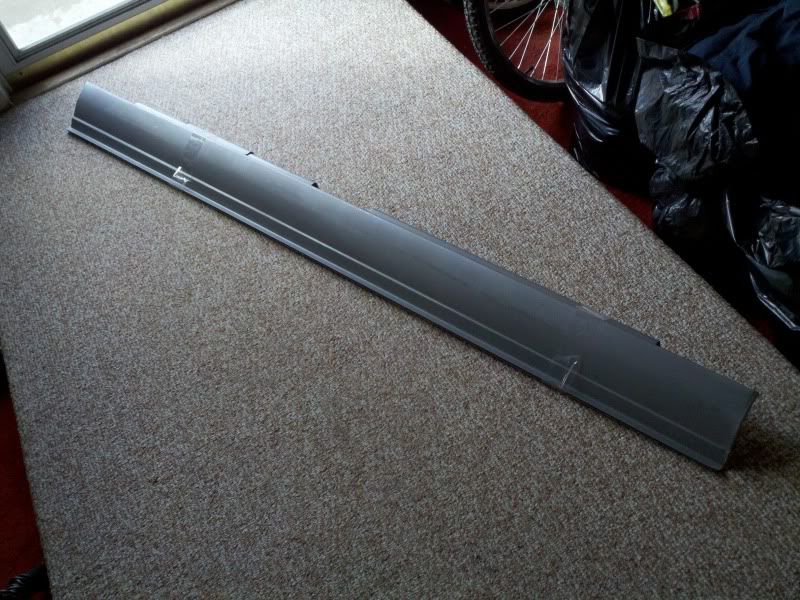

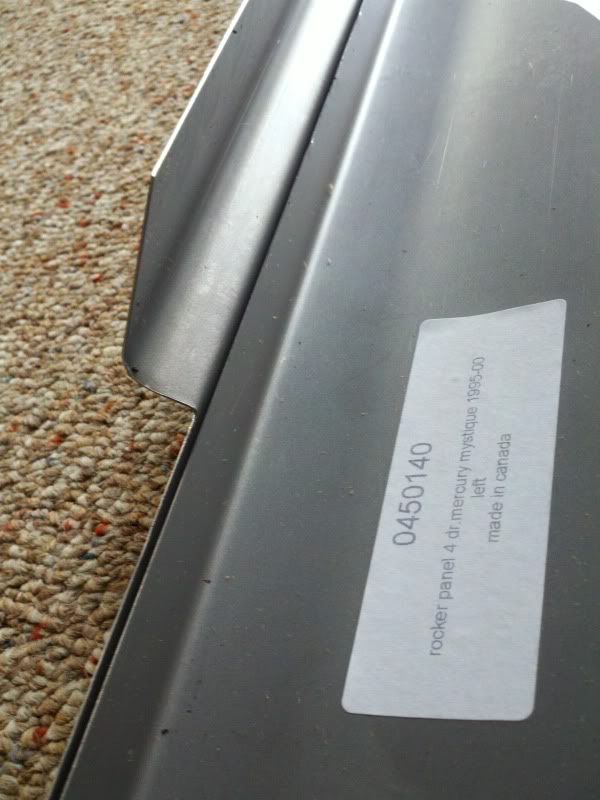

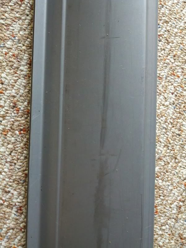

Rocker panels came today. They look really good! I cant tell how fitment will be since I havent cut anything off the car yet, but the curve and shape of the panels look spot on. I did notice that there are no triangle indents indicating where to jack the car. Other than that, they look to be pretty nice! Decent thickness for metal too. They feel solid.
That is really awesome! I might buy some just so the new owner of the SVT I am fixing can do this repair if they want.
One other difference I noticed was the curve from the door sill to the curve as it goes under the car. It looks to be a little bit sharper of a curve than stock, but that observation was only a sight observation. I did not compare it to the car. It wont really matter if you cut it below that curve, so you can retain the factory curve.
The ebay seller that I posted still had some left, and for that price, its worth it just to have around. Im not sure how many he has or how long he will be selling them.

For those in Canada they are made right here in Canada by Keystone. I got them direct from Brampton, Ontario Keystone warehouse. Bought a set for $70. Contact Joe Worron 905-850-1791 to order and arrange pick up.
Or you can order via http://www.crosscanadaparts.com/ will cost you more, essentially they come from Keystone anyway. Mine are due for replacement as well. Stupid road salt:(
