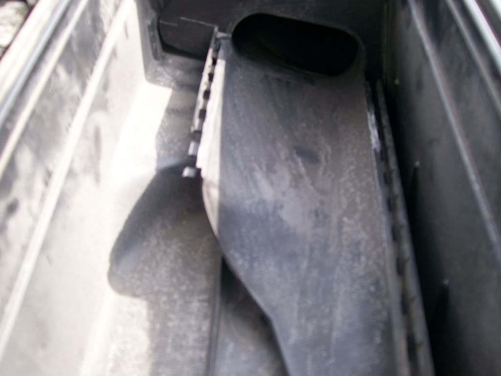

So I have been reading around and haven't found anything about optimizing the stock air box so here's my simple how to I have made to add on to the sleeper z intake. Do you want to keep your factory air box but want the deep sound like an after market air intake, well now you can. First remove the air box from the car and take off the top and remove the filter. In the bottom you will find a small intake tube on the drivers side of the car. That's where the air comes in to the air box. Pull that out of the air box and you will find it has clips on both long sides of it(hard to describe what it looks like). Pry the clips off with your finger on both sides on the bottom side of it,it's easy to do,theres about 10 on each side. Now you will have to halves but one will still have the triangular piece that goes into the rubber grommet into the frame, the top part is now useless. Now put the piece with the triangular end back in the box and reassemble the box and put back in. You will now find it sounds much deeper and powerful,kind of like a full air intake kit. If you have any questions, post away!!
