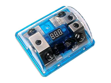

4a) a more pimpadelic fuse holder (if you're running amps in the trunk) is the digital ANL fuse block Item #: FB-1024D $40 (not required-just a cool upgrade)
