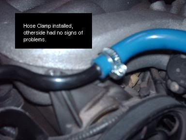

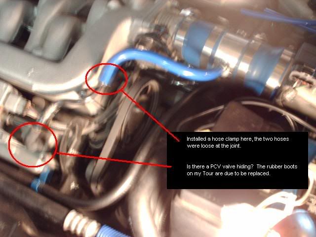

doh! Well I should have just shut my mouth. I had my car idling and tried to recreate last sunday morning so I turned on highbeams, defroster, and rear defroster. Car is running fine, then da der! CEL 174 and 171 Top end is lean. Car sounds fine, smells a little bit but always did when it was cold.
I replaced my IAC and cleaned the MAF sensor 2 weeks ago and the idle improved alot, but now I have a CEL for lean! I don't get it!
I also have my trubendz on for a little over a month. My tour has a shorty CAI as well, but it has been on for over a year!
I might try putting back the old air filter(ugh) and resetting and see if the code returns. I remember a zetec on a dyno run ran horribly lean from a shorty CAI. So maybe new IAC + Clean MAF + CAI = LEAN! I don't know!
