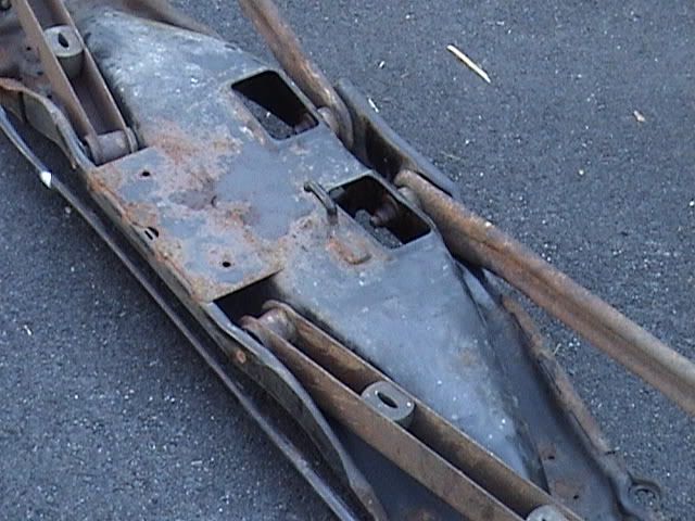

Hey JD-give me a close up of that subframe and the buttressing on the sway bar "socket"!

The pivot points of the controll arms (which are metal tubes the bolt goes threw that attaches it to the subframe) do not (or shouldn't) turn. Really those remain stationary after you tighten the controll arm bolt. The bushing around the tube is attached to it and then the controll arm. This is why it has a spring like action too it if you where to remove the arm to knuckle bolt you notice the arm kinda moves up in motion and if you pull down on it, let it go it will springs back. So using lube shouldn't help the bushing. Notice in the picture after removing the old sub frame the controll arms are standing up. If I where to loosen the arm bolts they would drop to the ground. This is proof that the arms don't really pivot on the bolts.
I would just replace them if you have high mileage. Mine where 28 each.

#1379759 09/26/05 05:29 PM
Joined: Dec 2004
Posts: 508
J
J
Joined: Dec 2004
Posts: 508
JD a.k.a Fingers "Don't Panic" '98 Contour GL 2.0L VCT ATX 88k '98 Contour LX 2.5L MTX 120k Street racing can kill just less of a chance with a 2.0
