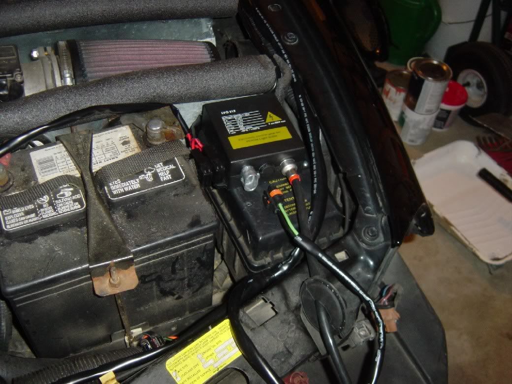

I got my kit from here
however they had a kit going with wiring harness and D2R bulbs for $300..I got that and sold the D2S bulbs for a pair of 9006 rebased Phillips D2R bulbs from here So basically the 9006 base on the bulb enabled me to easile use it as a regular bulb and lock it into place in the headlight.
as for the wiring harness, its kinda plug and play. the blue sockets pictured below hook up to the the stock plugs..then black/orange go into the ballasts..then there is one that easily connects to the battery and another for ground..installation took me less then 15 min, I couldnt be more happier with this..I mean I turn mine on and its like my HID's are stock looking, not like the crazy blue blue ones u see on other cars. My kit looks absoloutly stock and 4100K is the BRIGHTEST color u can get, the higher temperature you go, the more weird the color is
hope that helps..need any other help, feel free to ask..Im like the HID masta now
